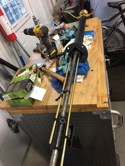

Today is the big day! I have all the rivets out except the quadrant rivets. Hopefully I'll not have problems with those. This has been quite a project, way harder than the later columns. What I did with all the spark and throttle rivets was to file the heads down until the remaining portion of the rivet was paper thin. I then used the remaining portion of the 3/32" drift punch to drive them out. The riveting machines Ford used must have had a great deal of pressure, because if you file them flush, you can't even see the outline of the rivet.

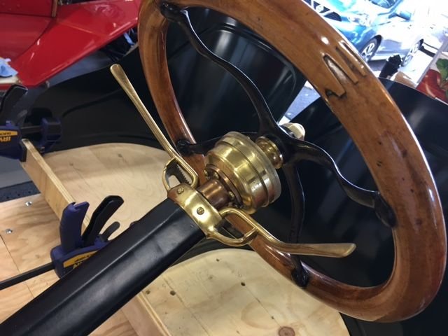

Re: 1914 Steering Column
Hi Larry, I followed step by step part I & part II. It was a success. Very well presented.
The link: https://modeltfordfix.com/restoring-a-m ... ng-column/
Picture when is done, hope that help.
Thanks for posting! I've done a 1925 steering column, which is similar, but must less difficult. This '14 column is way more involved, and I have come up with some interesting ways of driving out the small rivets that hold the spark and throttle levers to the rods. I see from the above photos the spark and throttle rods appear to be solid brass, which I don't intend to do. I'm willing to bet they don't have the holes pre-drilled for the spark and throttle levers? I'm going to have the original rods brass plated part way down as original. The brass plating doesn't show in the engine compartment.
Hi Larry, the brass rod have have the holes pre-drilled for the spark and throttle levers as well. I bought them at Lang's and I'm very please with it. But restoring 1914 steering column it is not an easy task. Need a lot patient and time...
