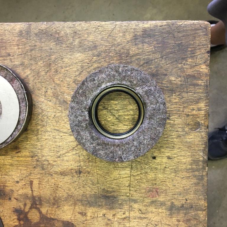

I pretty much buy just TT inner axle felts and make the rest of the felts I need out of them.
And just like the cars, the TT should have a felt on the inside of the hub too. The outer cap is very thin and there isn’t much room for a felt. It also seems that some TT’s may not have had an outer felt under that cap, but just the felt in the hub. I do like to put a washer, felt, & cap on the ones I work on. It seems to work well to put a thin line of permatex ultra black on the washer, set the felt on it, set a weight on it flat on the workbench and let it cure 24 hours. I do the same thing with the wheels. Lay them down, put a thin line of ultra black in the channel, install the felt, put a weight on it and wait 24 hours. Good inner seals are helpful. I make my own out of solid stock.
Making up the outer felt & washer:
Making up the inner roller bearing seal container, modern seal, & felt combination

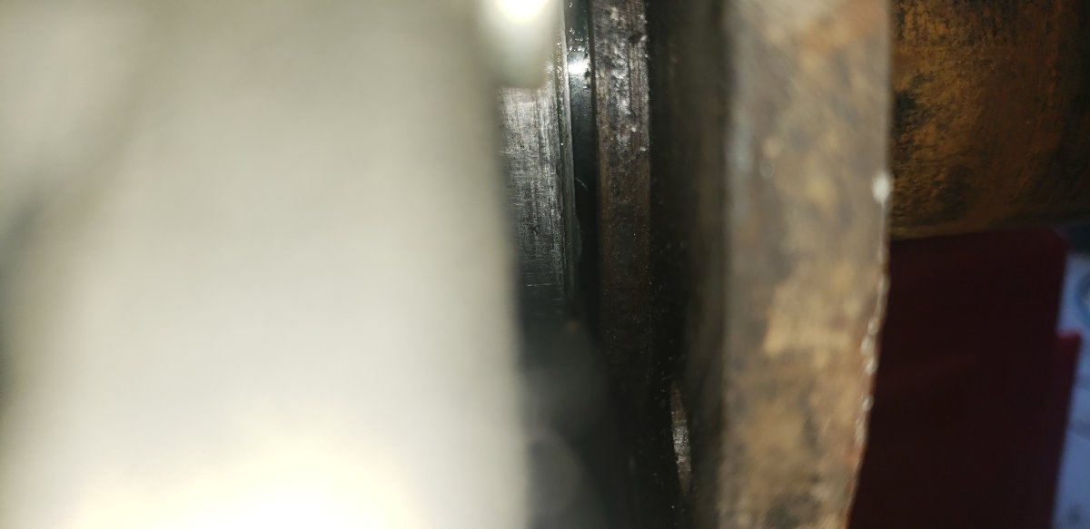

The gap between hub and washer on end of tube is less than .125. I estimated 1/4-5/16 in previous post. See picture. After seeing gap it appears there is very little room for the felt under dust cap. You can see the edge of washer in picture.

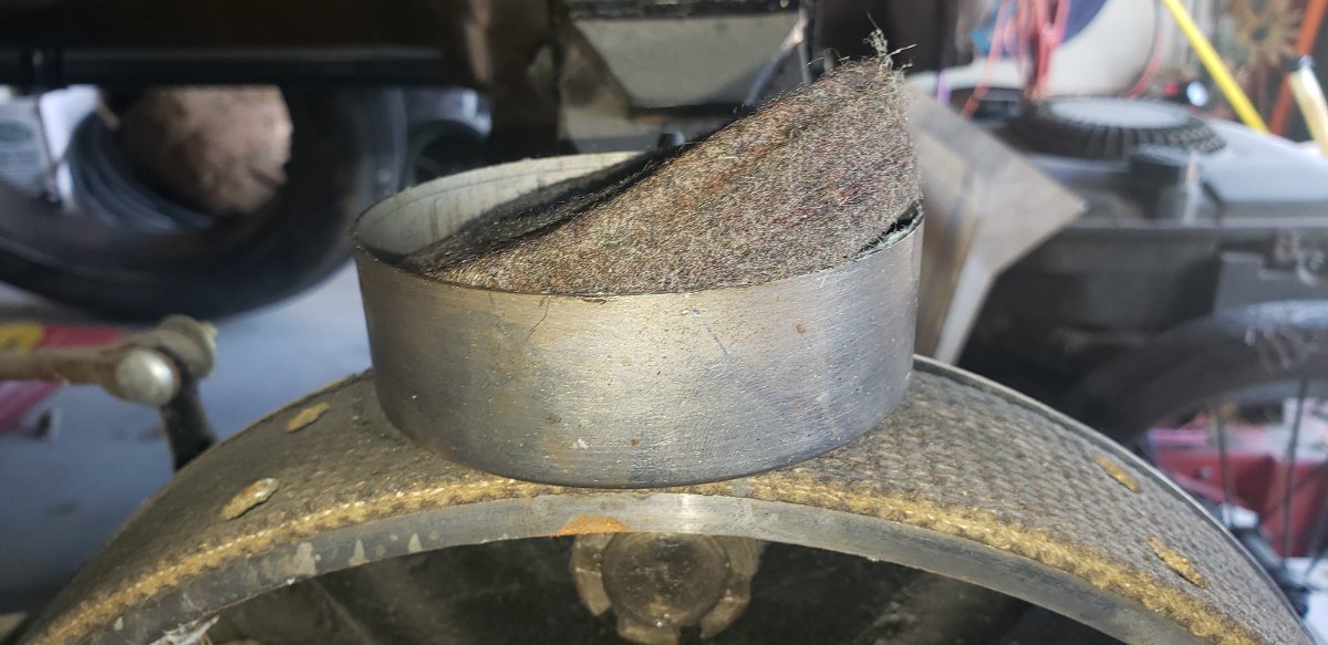

Dust cap and felt dad installed. Pretty sure they came from Lang's. He bought lots of parts from Steve.
The new dust cap dad installed is 1 inch deep, estimated at 1.25 above. Looks like it should be driven all the way on to tube. Then install an x thick felt seal.
Comments?

There never was a felt under the cap during production. Felts have been added over the years but they are not original to the TT. If you do install or manage to install a felt under that short little cap, don't forget a washer for the bearing to rub on.
