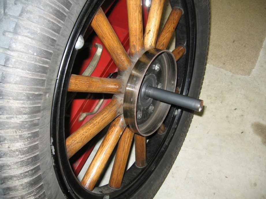

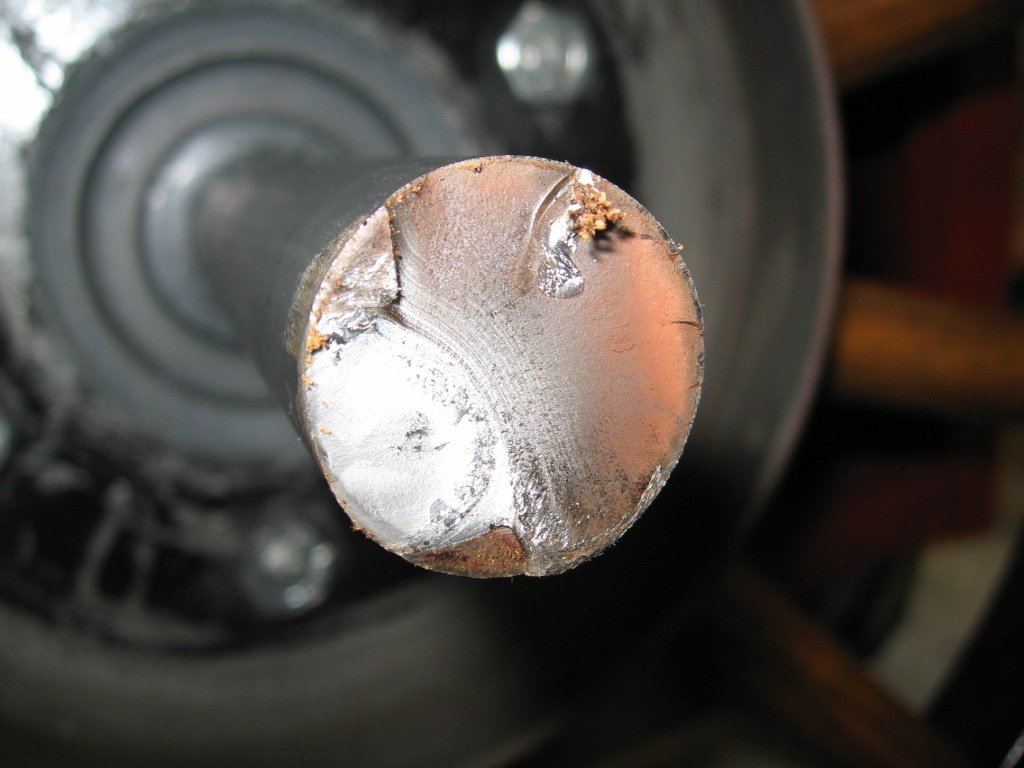

Post by CudaMan » Thu Mar 11, 2021 12:46 pm
My 1924 sheared an axle shaft a few years back. I use OEM Ford Hyatt bearings. From the rusted surface, it looks like the crack had been spreading for a long time. The location of the crack lined up with the spring "fingers" that supported the Ford style leather inner oil seal. :)

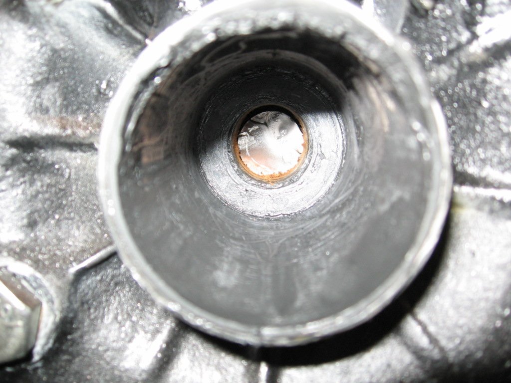

Seriously, my theory is that the hard steel spring "fingers" backing up the leather seal were rubbing on the axle shaft, and over the years a crack started in the scratches and slowly propagated in fatigue until it finally broke.

It’s very very common to see a broken axle shaft that is broken where the ‘26-‘27 Ford style seal has scratched a little groove in the axle shaft. So common that you shouldn’t re-use an axle shaft if it has even a hint of a groove there. It’s also something that was known about back in the day. I seem to recall mention of it in an old reference book or a trade magazine like Ford Owner & Dealer or something similar.

While the torque loading may be different between Model T and A, Mark's axle clearly failed in bending mode due to metal fatigue. fwiw, jb
