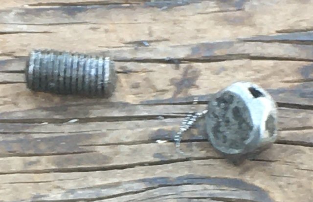

After careful study I determined that a failed original bolt conspired with a lot of worn parts to cause a significant problem.
broken bolt
broken bolt
This bolt was in the ring gear holding it to the differential casing. It sheared off and was held to the ring gear by it's safety wire. As you may see in the photo it lived that way long enough to get tumbled like a rock at the beach... rounding off the edges until the safety wire broke. The bolt head then found it's way between the pinion and ring gears. This snapped the pinion in half and broke the Woodruff key and the keyway of the driveshaft (on the taper). The force was so great that the differential casting broke. This sudden jam caused the triple gears which were on worn pins to jam teeth together (because of looseness on the pins) and snap off a triple gear tooth and allowing the triple gear to go out of time seizing the transmission. The result was broken shafts and bushings on the low and brake drums, trashing the drums. The bushing on one triple gear shattered and bent the triple gear pin trashing the flywheel.

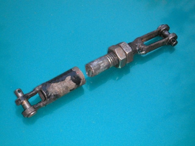

Prior to redesigning the slider I used the one which I purchased with my accessory brakes. After using it for a short time I found that the brakes faded in use. The problem was that the 5/16" all-thread rod used in compression to push the brake mechanism failed by bending in the middle. You can see in this photo that even after straightening the inadequate rod retains a bend.
Vendor designed slider
Next you can see the design I came up with to replace this setup. I used 1/2" galvanized pipe, a 1/2" bolt, and two clevis adjusters. They were welded together and replaced the manufacturer slider. The pipe piece slides over the 1/2" bolt piece and is adjusted with the jam nuts. There is more than enough of the 1/2' bolt inside the pipe to keep the interlock from buckling. I have been testing this design for over 15 years and probably over 30,000 miles.
Horlick design slider
This design is both adjustable and so stout that it continues functioning under the forces encountered in the most severe panic stop.

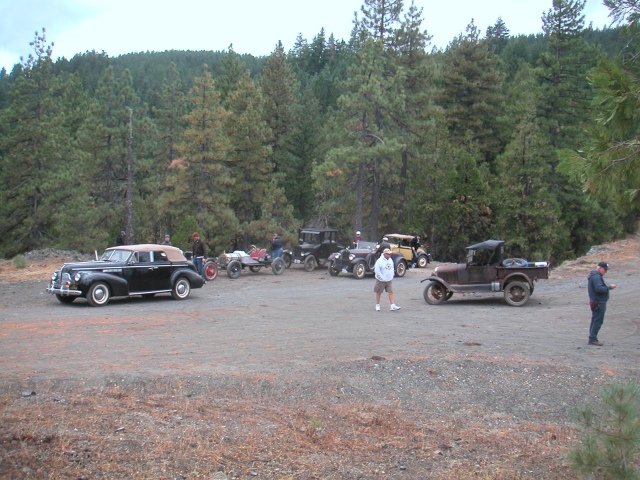

On a killer steep winding downhill Lee's coupe broke it's Ruckstell shift tower going into free-wheeling mode. Lee had only his service brake, and apparently no lined parking brake. This car is one which Lee had bought and driven throughout high school at least 30 years previously. He finally got it going and this was one of the first tours he had driven. Below is a photo from the rest stop previous to the accident, Lee had been driving near the back of the pack but since this was to be the last stop he moved up to the second slot behind the leader car, Rusty. Lee slammed into the rear of Rusty doing at least 50 mph, my Horlick design interlock was part of the winning combination that time around. The following summer 2010 photos were after Lee, Rusty, and I got the procession stopped at the side of the road.
I later got Lee a new Ruckstell tower, but over the past 11 years that coupe has sat in Lee's barn awaiting repair.
Here are a couple of photos from that day:
Rusty at right Coupe in center... just before crash.
Rusty right where he stopped Lee's Coupe.
Lee pointing out the dime size mark his coupe left on Rusty.
