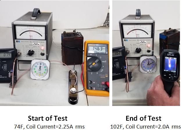

Hook up the coil primary to fully charged 12V Car battery (note the float voltage 14.63V) and wire directly to coil under test (bottom power terminal to side timer terminal) allowing it to buzz continuously with a proper 1/4" spark gap. Coil current is calculated using a HA50-100 (100mV/50A = 0.002 Ohm) current shunt resistance. Voltage is measured across the current shunt using an Lab grade HP 3400A RMS voltmeter with accuracy of better than 5% from 10Hz to 10MHz. Coil current = (shunt voltage)/0.002 Coil current was observed to vary between 2A and 2.25A RMS, much much lower than could flow through the low (0.3 Ohm) primary winding resistance if the points are not opening very periodically and very consistently.
Temperature is monitored via Type-T thermocouple in direct contact with the iron wires of the coil core and by Flir IR thermometer. Elapsed time is measured on an analog clock with second hand.
Coil Core Temperature Vs Time.JPG (42.46 KiB) Viewed 3552 times
The coil Iron core reached a temperature of only 102F after 10 minutes of continuous operation buzzing on 14.6V DC battery. The hottest part of the coil was the High Voltage terminal which measured between 130F -140F as shown on the IR scan.

It is not good practice to allow Model T coils to buzz continuously for long periods (minutes); especially if you don't know if your coils were properly adjusted for equal and consistent firing Time. Coil core melt down can and does occur if the coil points malfunction (broken rivet or contacts) or anything that interrupts the coil contacts from opening normally (e.g. coil box lid) as they are supposed to open when properly adjusted. In the event of such a fault, coil current can easily reach the 10A to 20A range very quickly and cause a melt down and fire hazard. You can easily add fail safe protection to your car wiring by installing a 4A fuse in line with the coil box power wire in a discrete location. This is separate from the 25A fuse recommended to protect the main +6V battery power wire which does not protect from coil melt down.
