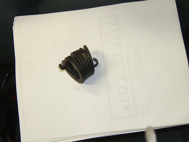

When I bought my T back in 2001, the buyer, who had bought my T in1996 and passed away from cancer in 2000, had installed a 12v system. When I got it home, I immediately converted it back to a 6V system. When I rebuilt the engine in 2010, the bendix spring had been slammed so hard by the 12v system, it was deformed so that the bolts were on opposite sides of the starter shaft and he brass ring gear had to be replaced.
The bendix spring is designed to return the bendix gear back to its’ proper starting point. The first picture is what an undamaged spring looks like with the bolts on the same side. The second 2 pictures are of the damaged spring that I found in my engine that had been deformed by high pressure caused by a 6V starter being connected to a 12v system and subjected to higher torque than it was designed to take. This kind of torque can also damage the teeth of your brass ring gear. Jim Patrick
