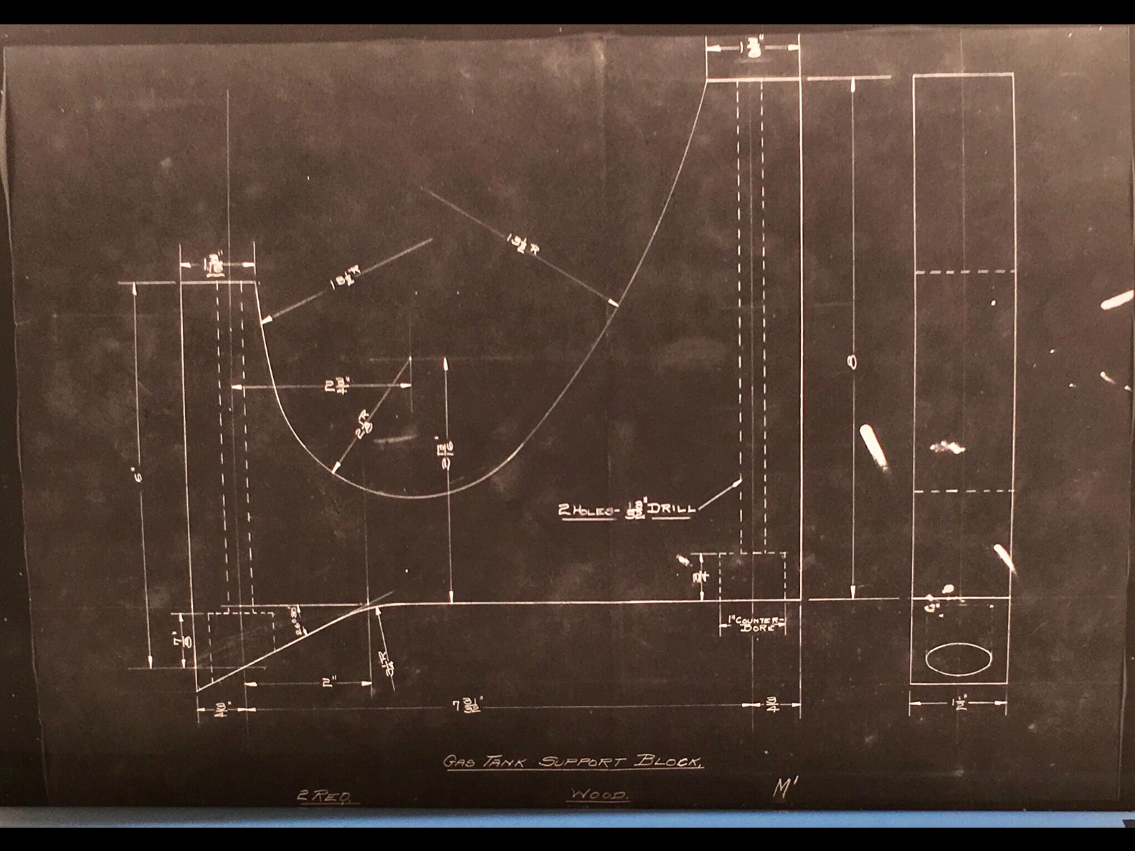

This is the gas tank support for an "M-I" racer:
This is the tank support for the 410 cu. in. radiator. It has a curve at the rear to accommodate the longer, raised frame that was used to lower the racer, and is also labeled "M-II:"

You posted two wood gas tank support prints. Both of them for modified frames (not straight).
The second print above is the "Gas Tank Support Block" (an elliptical tank) for the 410 racer pictured below in Ford Times. It also looks like the tank/mount on the "existing" racer that Ford has I have seen posted before.
The next "Gasoline Tank Support" (a round tank) is for another different frame. Different radius at the bend.
The photo of Frank Kulich driving at Algonquin in 1911 is a straight frame racer. It might have been one of the "stripped" racers but wouldn't have used either of the above tank mounts.
Does anyone know if that existing racer at Ford is the same car Frank Kulick was photographed in for the Ford Times?
There were actually six "Blitzen Benz" race cars that looked alike and apparently two of them still exist!
