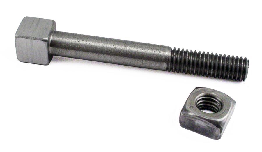

I would not worry too much about the oblong holes. The spring hangers and the bolt head in the hole in the cross member is what holds the spring in place. When you do get it out, look at the head of the bolt. It should be a tall head, taller than a normal bolt. If it is short, call Bob's in Loves Park Illinois to get the correct bolt. He has them manufactured.
Seriously, it looks like you need to spread the cross member using whatever method is easiest for you. If the axle is already detached, there is nothing holding the spring in place. A 12 year old could lift that spring out of the cross member. You could remove the bolt, but that does not solve the problem of the squeezed cross member.

David, Look at the bolt head. Why did you say the head should be taller than a normal bolt head?
I got the spring out of the cross member. After I took the bolt out the leafs separated a small amount and out came the spring!

https://www.modeltford.com/item/3838OR.aspx
There should be a square hole in the crossmember. This is what helps to keep the spring centered in the crossmember. A taller head will help you install the spring and keep it in place. The bolt you have is probably not original. The spring hangers just hold it in place. There was a discussion a gew years ago, but I cannot pull it up.

Here is the rear spring bolt sold by Snyder’s. As mentioned, it fits into the square hole and helps to center the spring in the crossmember so it can be secured by the shackles then helps to keep the spring centered in the crossmember. You will need to take your spring apart and paint the surface of each leaf with slip paint (black graphite paint) that is available at Tractor Supply. When bolting the leafs together, make sure the square bolt head is lined up properly to fit into the square crossmember hole. When I installed mine, the bolt head protruded slightly above the top of the crossmember. There is also a rubber spring cushion pad that goes between roof of the crossmember and top of the spring. From 1909 to 1920 they were leather. From 1921 to 1927, they were rubber. Jim Patrick

When assembling the leafs back together, after cleaning and lubricating, use the same piece of all-thread you used to disassemble the leafs to pull them back together. When the leafs are secured together with the two small clamps, exchange the all-thread for the bolt. Tighten, making sure the square bolt head is aligned properly. Grind off the excess threads leaving about 1/8” and brad the end so the nut cannot come off. Jim Patrick
