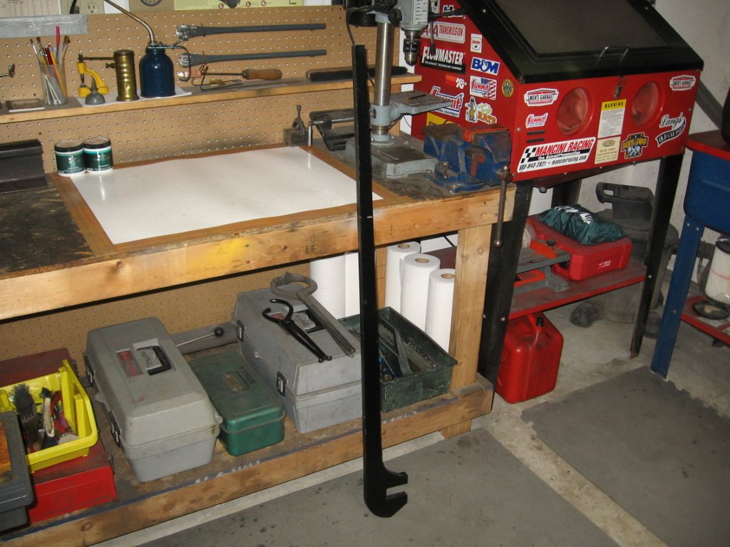

- Posts: 2546
- Last Name: Strange
- Location: Hillsboro, MO
- Board Member Since: 2013
Re: Front end wandering
Yes, you end up bending the end of the wishbone. Here is a modern reproduction of the tool. I bought it on Ebay, I think. Might have been the forum classifieds, I don't remember. It is 4 feet tall and laser cut out of 3/4 inch steel.
Before you bend anything, verify that your spring perches are oriented correctly. If they are installed backwards, the axle will tilt forward rather than lean back, making the car unstable.

There is another thing to consider. There are more than one length and angle of under-axle wishbones. There was a thread about that a year or so ago. I think it was in a thread where a member was repairing a wrecked front end.
I bought a wishbone cap and milled it to fit into the existing giant cavity and JB Welded it in place. It will have to do until I get a better engine pan. This method lowered the ball by less than 1/4". I made longer studs and I plan to reinstall my front axle this weekend.

Didnt know about different length wishbones. Must be 26-7 with the lower spring arch would be shorter.
I have seen where a worn mount is welded up & remachined with a ball end mill. The cost of that cutter turns me off. I do build up the wishbone ball with welding & grinding back to stock diameter.
No reason I can see your fix is not a permanent one. I wouldnt be in a hurry to find a "less worn" pan.
