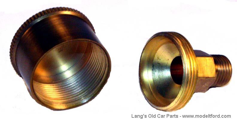

Post by Rich Eagle » Sat May 22, 2021 4:26 pm
Yes, the flip top cups press in. The screw on cups have a threaded base as well as the brass, knurled twist type shown here.
https://www.modeltford.com/i/c/2930001l.jpg
Thanks.It looks like the hex I am seeing is actually the bolt head, and the oiler presses into the bolt head. Is this correct? Thanks
