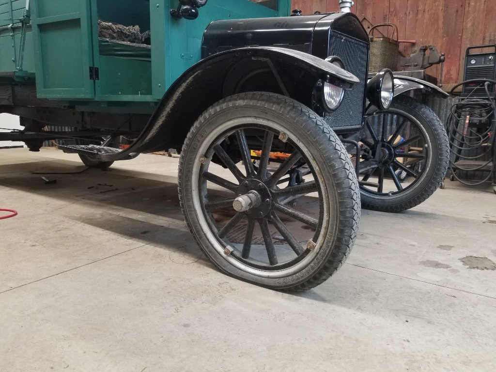

Post by Dallas Landers » Fri May 28, 2021 10:40 am
I topped off the tires on the TT a week ago( about 5 lb each. 1st time I have had to add air since I put it back on the road a couple years ago. Today I go in the shop and find the right front and left rear flat. I drove it to town last weekend. The only drive this year. I aired them up this morning and they were both flat in ten minutes! I will take them apart and see what the problem is. The front tubes are only 2 years old, I hope its not a tube failure.

Oh Im not complaining about is happening in the shop. I will check the valve stems. The air was coming out of the rim around the valve stem. Its a major leak to go flat in ten minutes. I just thought it odd to have 2 flats on opposite sides the same day. Just goes to show model T's get offended if you dont pay attension to them.😳

Ok, I couldnt take it. I had to see whats up with the flats. I pulled the 30x3.5 Kelsey from the front. Took out the tube and aired it up. Nothing found. Not leaking. Smack the forehead moment. I didnt check the valve core for a leak. Since it went flat in ten minutes after inflation, I was sure something major was wrong. I checked the valve core with the spit test after I inflatex the tube. Nothing. I also realized the tubes came with the truck, I had installed new Riversides on the front.
This is the only printing on front tubes

I went to the rear flat and inflated it to 35 psi. 1st thing on the list since my forehead is still sore, was to spit test the valve core. No leak there. I removed the tire and tube and found a small cut or crack at the base of the valve stem. Ah ha I found it. NO I DID NOT! I inflated the tube and found no leak anywhere. I inflated both tubes and let them stand there. I turned out the lights and went to the house at this point. Tomorrow I will take them for a swim in the horse tank.
Same print but no name. Made In USA on both tubes. These tubes came with the truck when I got it. In fact I have never had the rear tubes out.
I think the old bit#* er a girl is mad at me. Im thinking valve core as well Allan. I needed the extersize in tire removal anyway. Its a good thing we like working on these old rigs.

Finally got back to the TT. Both front and rear were leaking through the rubber about 1/2 way up the valve stem. One had a visable split when aired up. The other had no visible signs but made soap bubbles. Lucky I have extras. Now I guess I will learn how to replace a valve stem.
