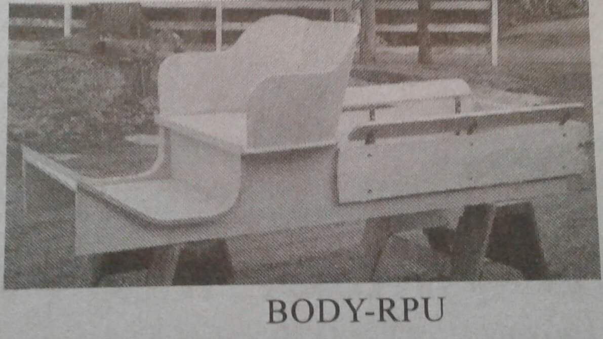

Back in the day, a lot of Model Ts were sold by Ford as bare chassis, so the owner could purchase his own body to fit his needs. You may wish to research obtaining a bare chassis and then installing an open express pickup body. Here is an example sold by Langs
It is not just how far back the seat is, but also how high the seat is that will determine how well the car will fit you. An express pick up body can be had either open or closed, could be purchased, or self made, and dimensions altered to fit your needs, and at the same time be period correct.
In the example shown above, the seat cushion could be made higher, the padding on the backrest narrower, to better fit you. A customized windshield and roadster top could accommodate you further, while still looking period correct. Here is a period photo of a pickup made from a roadster, compare to the body shown above:
Good luck, and have fun.
