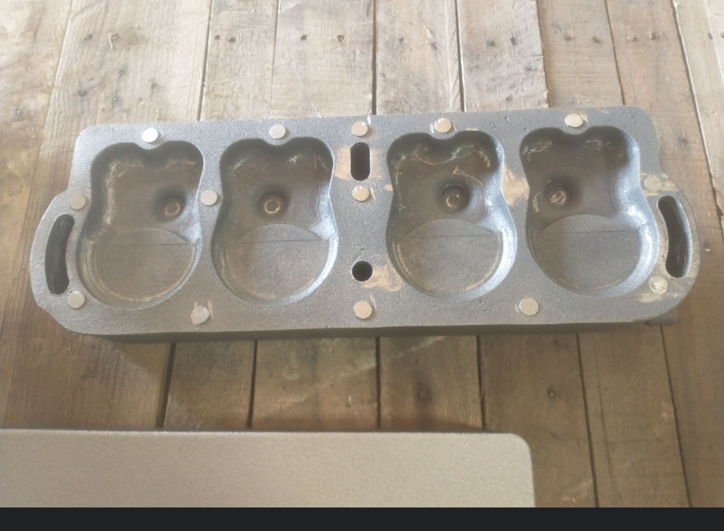

This is a sample the quality heads he produced. Having 1 aluminium and 1 iron head made to test.
Model T Tom

Here is a model A Miller head in iron. Quality work only.

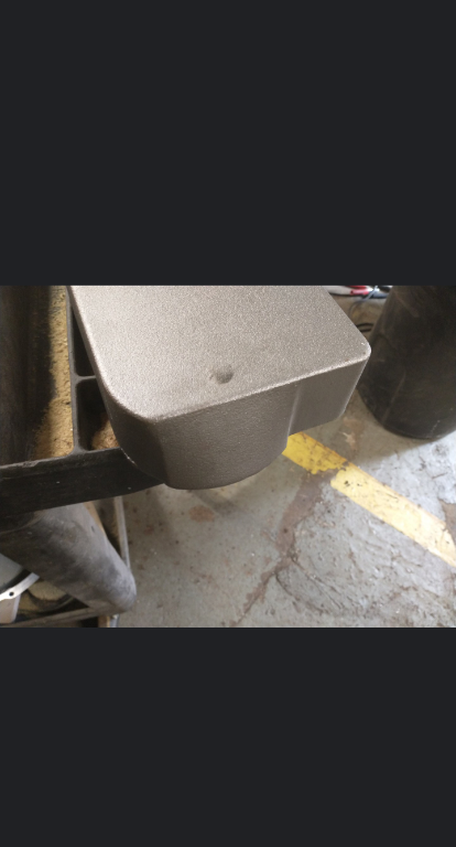

First 2 head's poured today. They will be shaken out tomorrow and we will see what we got.

Re: Miller head update
Better picture
Michael Peternell
- Posts: 730
- Joined: Sun Jan 06, 2019 11:00 am
- First Name: Michael
- Last Name: Peternell
- * REQUIRED* Type and Year of Model Ts owned: TT gas truck, T tractor conversions, '15 touring, '17 speedster, '26 16 valve speedster
- Location: Albany mn
Bottom and top side photos don't seem to match?
- Posts: 6634
Michael
I was wondering the same thing and wonder now if it isn't a function of camera angle. As an amature machinist I could see where the gasket side would be molded to a machinable profile with the water jacket being above it and squared off. All views have so little depth of field that within an inch or two the far side is shrunk beyond the line of sight. Look at the underside view and magnify it while looking at the right/forward corner and see if you don't happen to see what appears to be (?) a squared off profile lurking below/beyond the seal surface.
A 3/4 view would be most interesting and at least dispel confusion
At any rate, pretty nice looking castings with an absolute minimum of obvious porosity
Just can't be unless there's a flat top hiding the rest? Not trying to be any sort of expert! I'm definitely on the other end that!Scott_Conger wrote: ↑Wed Jul 14, 2021 8:54 pmMichael
Better pictures
- Posts: 6634
Thanks Tom
that's exactly what I had imagined was lurking!
that is one beautiful casting
- Posts: 4994
Looks like #3 spark plug hole is centered between the valves. The others are over or closer to the intake valves. Why is that? Optical delusion, experiment, special clearance?
Optical illusion
- Posts: 6634
Michael
you a believer yet?
you a believer yet?
Yup! My bad!
