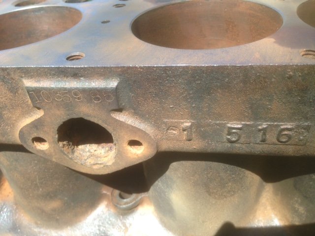

So I listed a 13 engine for sale and put in the ad that it had been restamped-. It was then brought to my attention that the number pad itself was rather large. It infact is. I have a 12-13-14 to reference to and those do have the smaller no.pad. I don't understand how it can have the cast no. On the block and then have the lg.no. pad. Thank you

Did someone remove half of the 3?

Someone here listed a 12 block for sale. When I examined it, the pad had been shortened, it didn't have the threaded freeze out plugs, and other things that made it a non 12 block.
At least YOU are being honest...

I have a March of 1913 block and the back of the block at the water jacket has the early type 1913 block lip.
The early blocks at the back of the water jacket are not sloped like the later 1913 blocks. If it is a modified February 1918 block it will have the sloped back water jacket.

I have another engine the block reads 10-27-13. The. Small no. Pad says Jan. 14. Other than the large no. Pad on the one for sale they look identical. I can't get over the cast no. On the block. Also- my other engine has thread in freeze plugs; the one for sale. Does not

My guess is when the number boss was milled away to remove the serial number, then 'somehow' the 8 in the 1918 block loss half of its loops to become that "3".
Here is an 1917, and shows the proper length boss for the number stamp, an earlier block like this 1914 has the correct small length boss.

I'm slow; but I just couldn't understand how every one was coming up with 18. I'm just not a deceiving person. Just simply grind the 8 and there's a 3. Throw a low head on it and there you go. I apologize to every one I did not mean to try and sell a deceiving part.thanks everyone

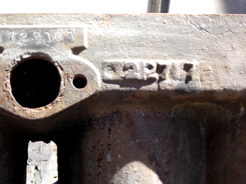

As mentioned above, the engine number boss on the block in question is of a later style, beginning in late 1915 or early 1916. When the serial numbers hit the one million mark the extra digit made for a tight fit for the the guy stamping in the numbers. You can see what an original 1913 number boss looks like and the reason why the boss was lengthened in the 1916 photo.
There may be other small changes to the blocks in the 1913 time period that I don't know about. I hope what I've presented helps.

There are other changes during 1913. Early 1913 blocks had a single reinforcing gusset supporting the rear main bearing while later in 1913 this was replaced with a pair of gussets.
One other change is on the block flange that bolts to the pan - on the right side just back of the front cover. During 1913 the first bolt hole got a reinforcement, which remained there through the end of the non-starter engine production. However in early 1913 blocks this change had not taken place, as pictured below. The non-reinforced bolt hole is from the Feb 1913 block pictured above and the reinforced block is a 1918.
Of course the so called freeze plugs also changed during the 1913 year, from the pipe plug style to the hammered in welch plug.There may be other small changes to the blocks in the 1913 time period that I don't know about. I hope what I've presented helps.
Rich C.
