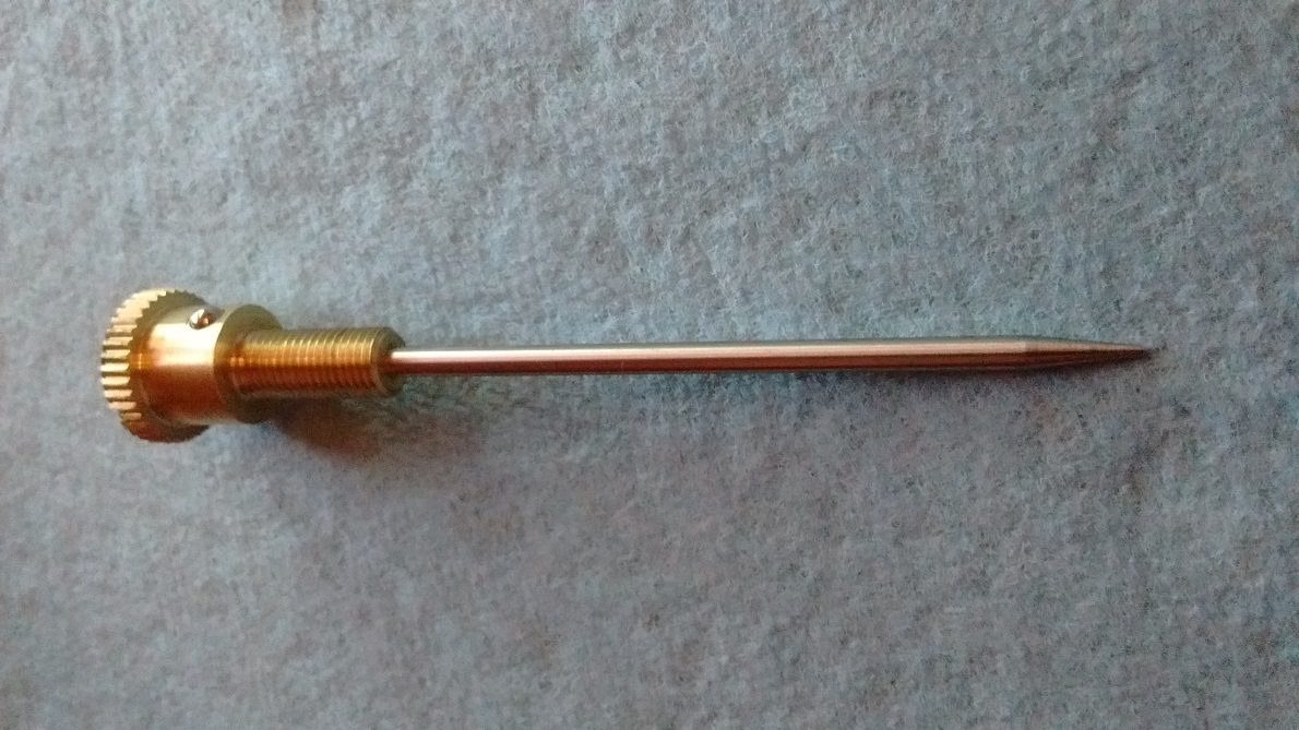

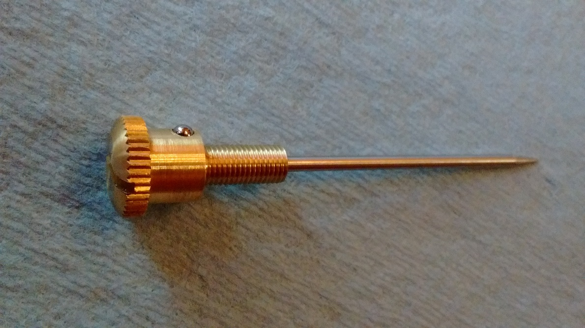

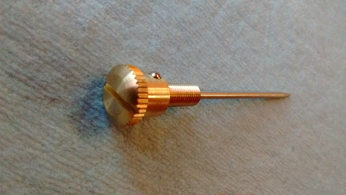

I have an OF body which was sold to me on the cheap because the low speed and high speed needles were missing from it. The only place to get replacements would be from another Stromberg, right? Wrong. I felt that it would be a shame to leave it in that condition and felt there would be no net gain to my stable by stripping another OF to save this one, so I have replicated them. This one is complete and the fuel needle will be completed later in the week once a special reamer shows up via the UPS gal.

Cool, very nice.
Making more?
Making more?
Topic author - Posts: 6705
Re: First Stromberg OF needle fresh off of assembly jig
Yes, I have blanked parts for a number of them

And the longer needle shouldn’t be a problem?

not at all
in fact, the long needles are already in stock...just waiting on a special diameter reamer to fit them to the adjuster

Looks like the body has been machined out of one piece and the needle inserted. Is there a rivet that holds it all together? Nice work, very delicate.
Thanks Rich
No rivets
assembled just like the original
there is some small variability in dimensions on 8 original parts which were inspected, with a couple of dimensions being critical. All my dimensions are tightly controlled around nominal values with small tolerances, which keep variability of the new parts within the population of old parts in hand. Certain critical dimensions are controlled very tightly
No rivets

Are the outer rings coming next?
Put me in for a couple sets when you get them finished, the needles I mean

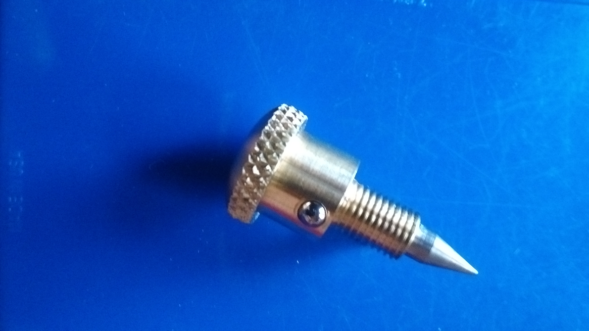

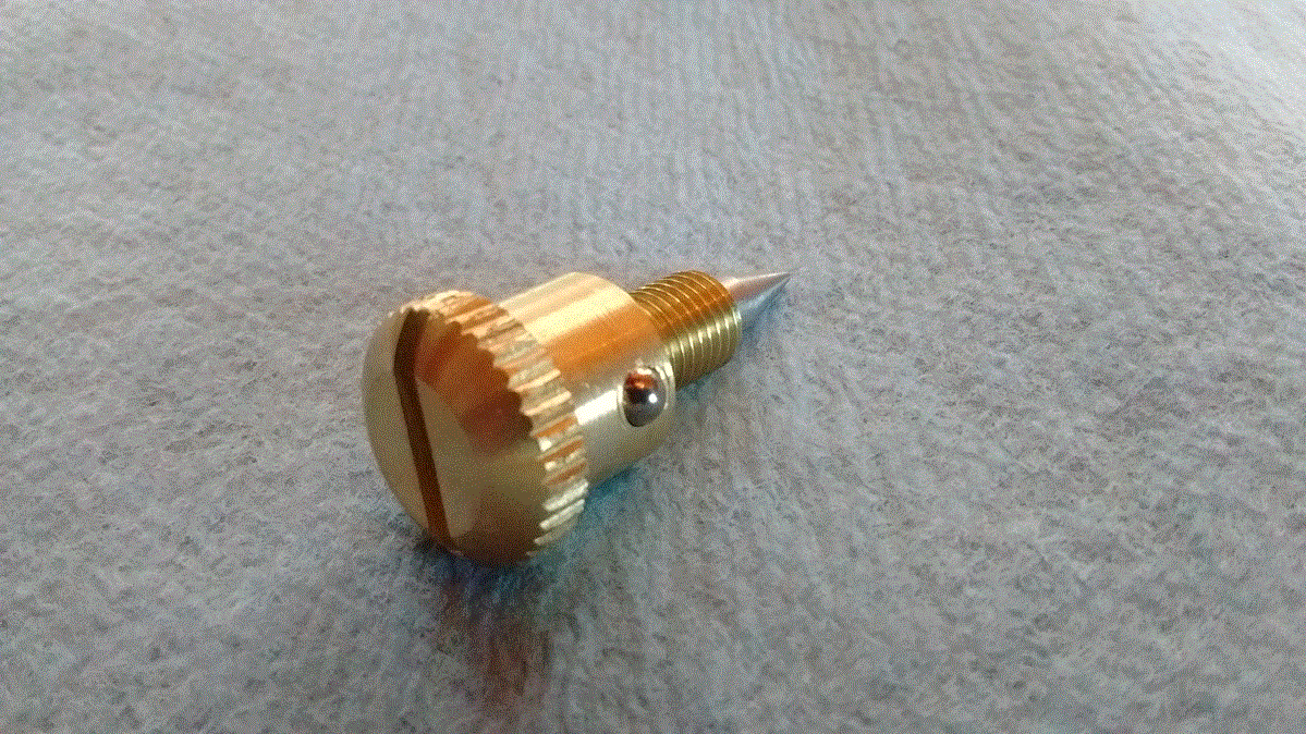

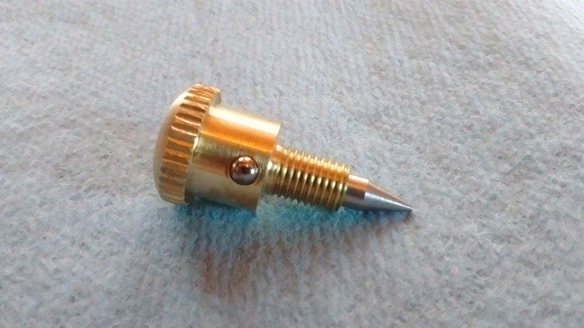

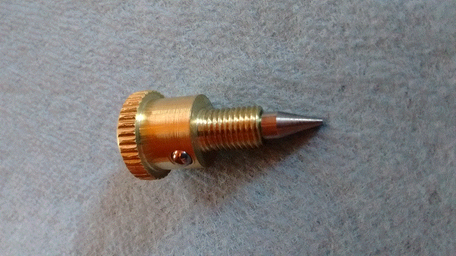

New pix of another needle style
The last Strombergs came with machine broached wells and diamond knurled adjuster heads...I think they are a nicer looking part and are easier to grip. Sorry for the terrible background and color...

Scott, Wow, that is some beautiful work!! I watched the OF that was on EBay for months with the missing needles and thought it sure would be nice if somebody starting making some.
Nice Job, I prefer the earlier style knurl

Beautiful work, thanks for showing. It took me two days to fabricate the bracket that holds the choke adjusting cable on my OF. Had to cut the blank from sheet steel with a jewelers saw, then drill and bend a complex shape. But it’s noting like seeing your expert machine work.

If you have a complete Stromberg, you do not need these as they are not an item which wears out. I appreciate the sentiment and your interest, but don't want to foist something on someone if it isn't a needed part.
To all: thank you for the comments. They were an interesting project. The remainder of the run are listed in the Classifieds.
