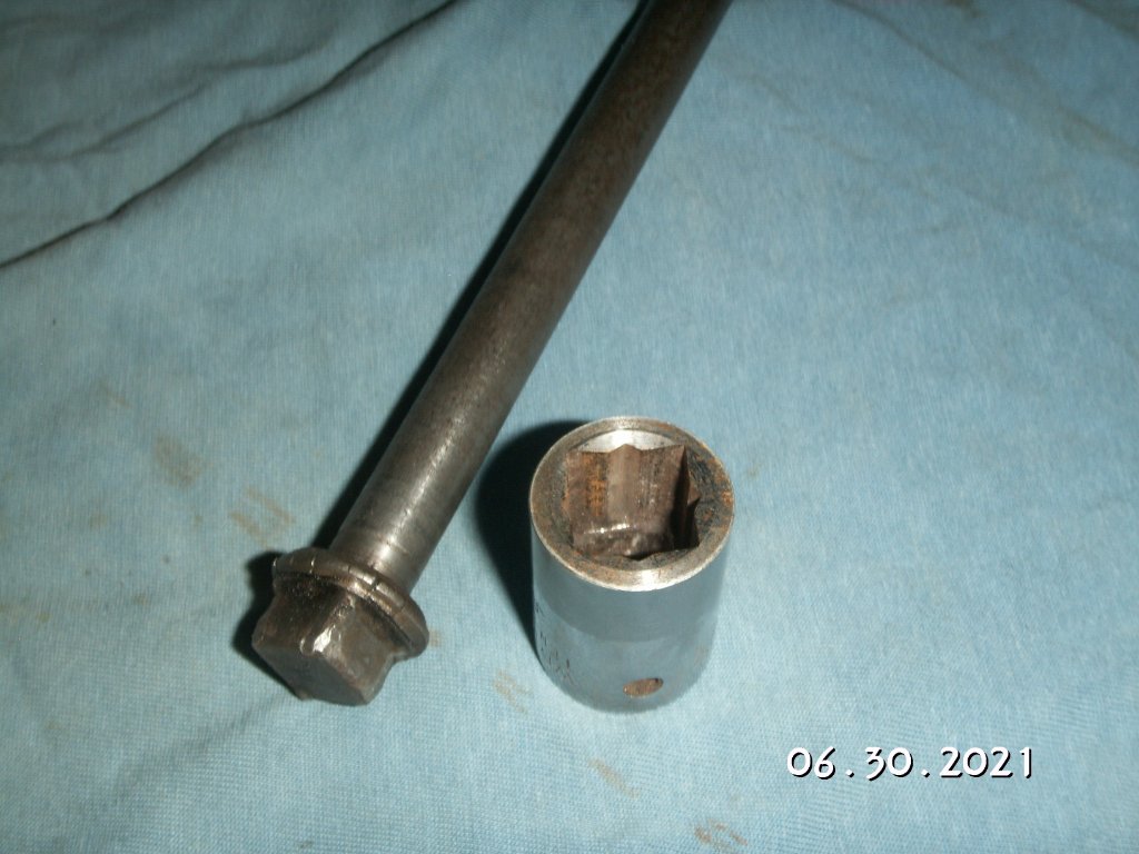

. This is a Snap-on, probably easy to find on line or in your area.
- Posts: 392
- First Name: Jim
- Last Name: Riedy
- Location: Sandusky,Ohio
Re: which socket main bearing cap
Here you go, the socket is a Wright 4fs18 and the wrench is a Mossberg 622 more than likely a copy of a Ford tool. Jim
