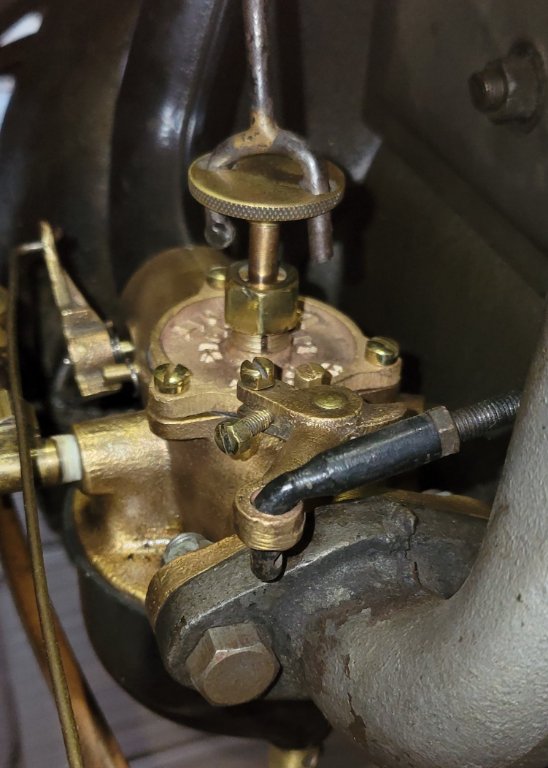

John-
If the carburetor rods on your 1911 and 1912 cars are original, one end will have an L shaped bend and the other end will have a #12-32 threaded end. A female threaded L shaped end screws onto the rod and allows for some adjustment to make it a little shorter or a little longer. Your timer rod would have a similar set up with a swivel screwed on the end of the spark rod.
I believe the threaded end of the throttle rod is supposed to be on the steering column side, but it makes for an easier adjustment if it is on the carburetor side.
Keith

Post by troutjohn » Wed Jun 30, 2021 5:46 pm
Hi Keith, thank for your reply and picture. That is the rod that I have. It is fine for the Holly NH carb but a 1/4" - 3/8" short for the Holly Gs. I'm at about the end of the thread on the rod. I'm looking forward to the longer rods from Lang's. I do love the Holly Gs - easier starting, more power up hills and faster, and of course looks great.
John
