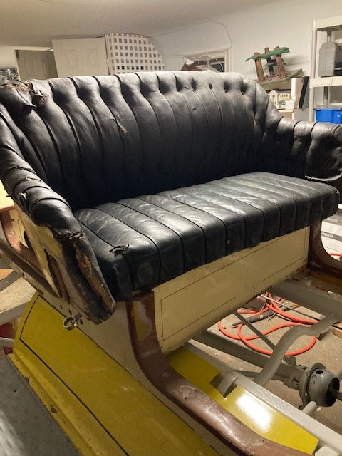

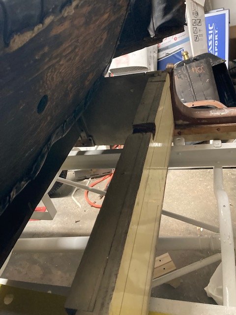

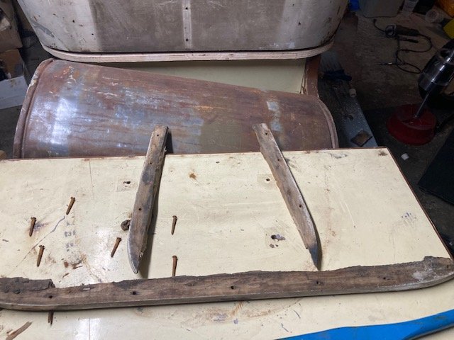

Built what I think is a good base. I set the seat back on construction paper and traced it out. Then cut a template from that out of the paper, trace it out on a piece of birch plywood and cut it out. The fit seems good. I was able to take off the shard remains of the original base relatively easy by un-screwing it with care. This probably isn't a Ford seat but it should be good enough.
- Posts: 4393
Re: Supporting the Mystery Seat on a 1912 body?
Looking good!

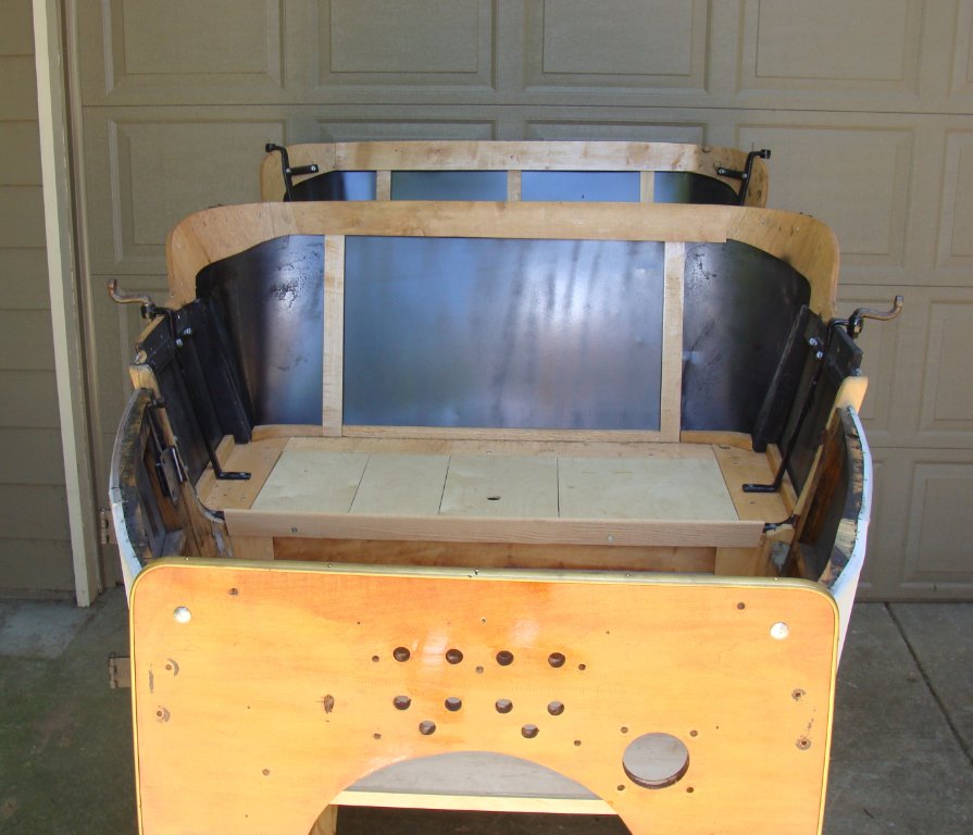

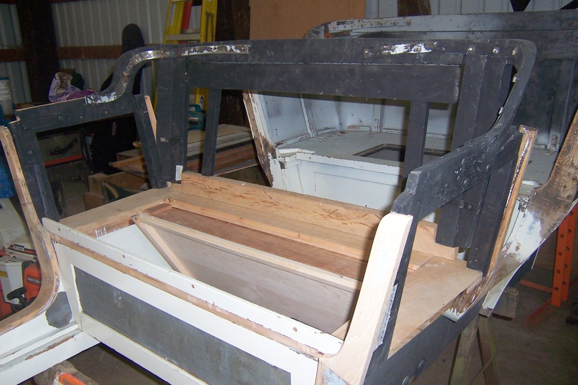

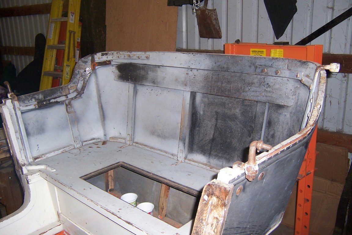

Here are some image of the supporting brackets on both front and back seats on my late 1911:
before restoration there was a bunch of extra angle brackets:
Note the side or the seat angle out and are not 90 degrees.
I hope these images help.
Don't forget to make a small lip for the hatch cover on your seat riser for the cover and cut out the gas cap hole.
-Keith
-Keith

Your build is progressing nicely and the seat looks good. I would like to suggest that you round off the corners on your plywood seat bottom on the front so you don't catch your legs on it getting in and out of the car.

Thanks, I have an upholsterer who removed the original cover and is going to make a new one. However, the seat body is back to me for continued refurbishment and painting, toothpick the tack holes, repair the damaged or missing wood, fill holes. Here is the interior of the mystery seat. I am wondering if I can or should change out the existing mystery top body brackets for known Ford top body brackets. The 2 front body brackets have been scalped at the base. The 2 rear ones are intact. Not seeing anything on Lang's that would do the job. I have 2 weeks to figure that part out.

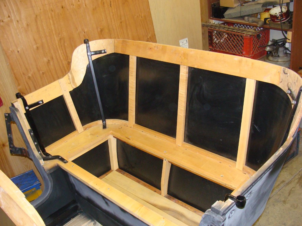

It looks great. Is that black plastic sheeting on the inside backrest? If so should I be doing that too and why?
KWTownsend wrote: ↑Sun Jul 25, 2021 12:24 pmHere are some image of the supporting brackets on both front and back seats on my late 1911:
-Keith
Ignacio-
The black that you see is the painted surface of the inside of the sheet metal. It was painted (along with all the body irons) before the woodwork of the backrest was done. The outside of the sheet metal was left in grey primer, which I re-painted with black primer, before painting the car with midnight blue.
I wanted you to see some of the jerry-rigged extra supporting brackets that had been in place before correctly restoring the body.
-Keith
-Keith

My mystery seat irons have been scalped. Are Ford ones available for a top? I have 1 week.
- Posts: 4393
I would weld/bolt/rivet a "foot" to the base of each of those original brackets and use those to attach the seat to the base. In other words, just replace what someone has "scalped" off in the past.ivaldes1 wrote: ↑Mon Aug 02, 2021 9:55 pmThanks, I have an upholsterer who removed the original cover and is going to make a new one. However, the seat body is back to me for continued refurbishment and painting, toothpick the tack holes, repair the damaged or missing wood, fill holes. Here is the interior of the mystery seat. I am wondering if I can or should change out the existing mystery top body brackets for known Ford top body brackets. The 2 front body brackets have been scalped at the base. The 2 rear ones are intact. Not seeing anything on Lang's that would do the job. I have 2 weeks to figure that part out.
