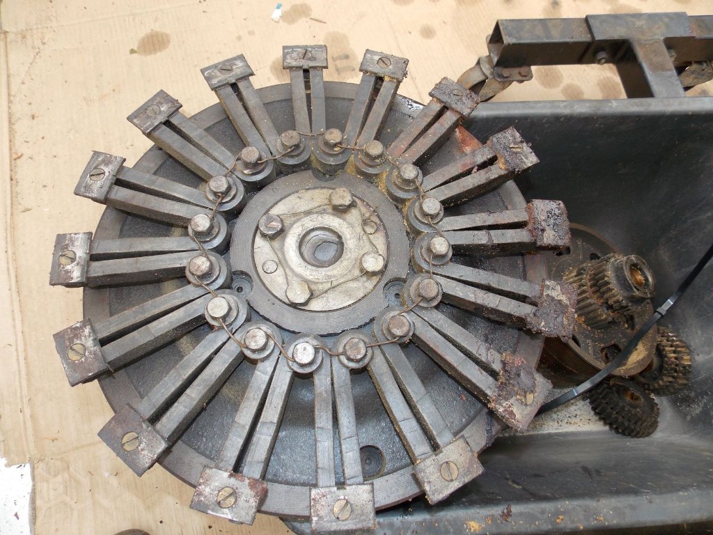

Since last week I am a member of the two pieces crankshaft club.
A while ago I bought a 1917 engine for a few $$. Last week I started to work on it.
Now I know why it was that cheap but here they say that you can't control the teets of a given horse.
Photos in attachment.
Andre

Looks like it was in pretty good condition before the crank broke! You are probably better off that it broke now rather than later. Since it appears to have had serious water in there, it really needed to be taken apart and cleaned up properly.

That's a first, haven't seen a fracture there on Ford cranks, have seen shortened Model A cranks break at welds there.
Must have been a real fun ride, with the motor still running at high rpms, but the car coming to a complete halt, with the entire flywheel and transmission falling into the crankcase!

That's also common with some of the Chevy Crankshafts that a few guys used in T's if they weren't done properly. Ralph Ricks had the same thing happen.
Yes you are lucky because it is common to have other breakage at the rear main in the aftermath.

I have seen a few crankshafts break that way. Often, it is in part the result of an improper grinding of the rear main. The radius between the flange and the bearing surface is very important! It also in part is often the result of a pan alignment problem! Either one alone can result in a break there. If an engine has both too sharp a cut on the journal, and a slightly misaligned pan, that is how they usually break.
Without a miss-cut on the crankshaft, a misaligned pan has a tendency to run though the rear main, and break between cylinders three and four. It depends a bit on the specific angle of the misalignment.

I never tried to make it running.
I paid $40.- for it in the state as it was, (photos in attachement)
Somebody asked me if it was a boat anchor. As I took off the head I found a lot of "desert" sand in the cilinders and the water jacket and no oil .
The head has 18mm spark plugs.
Andre
Belgium

Looks better than a few I have rebuilt. If the crankshaft breaking didn't do too much other damage? It may be a great buy? Otherwise, it looks like some nice almost early parts at least!

I think I found the reason of the broken crankshaft.
As I took the flywheel of the broken crankshaft part, I found a gasket between the crankshaft and the transmission shaft.
The four bolts were secured with a wire but were not realy tied. Flywheel and transmission were not tied to th crankshaft and lived there own
way.
I will take photos later and post them.
Andre
Belgium
way.

Sounds like a Volkswagon mechanic was the last one to assemble your engine. The VW engine is the only one I can think of that used a paper gasket on the crank to flywheel.
