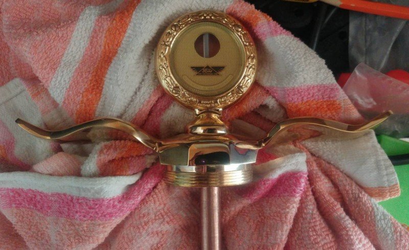

I did the opposite with my Boyce Motometer. It was in Chrome, also the radiator cap, but I needed brass (for my '16 Touring). I finally decided to do it by myself because I was concerned about this huge and quick temperature changes from bath to bath between 20°C and 85°C, as they could destroy the glass thermometer. And this Motometer is meanwhile really rare.
1. First I stripped (unplated) the Chrome - 5 minutes
2. Then I applied real gold. - Approx. 10-15 minutes
At the beginning I was afraid that color would differ too much, but see the result in attached picture, I never did electroplating before. The inner scale is true brass, all outer surface is gold plated. The big advantage is that this works with parts in literally every size because you work across the entire part from one end to the other...
With real GOLD as surface I will not have to polish it again and again, it will stay shiny ....
Costs:
I payed approx. 100$ for all four chemicals and textile tampons. (But without the power supply, because I already have one in my electronics workshop.)
If you are interested, here is the Link: www.real-gold.de
It is for sure worth a try. And you can easily re-plate spots when needed.
All you need is a few galvanic baths and a cheap but adjustable power supply (up to 12V / 10A output, both adjustable separately). I am sure that such chemicals also are being sold in USA.
