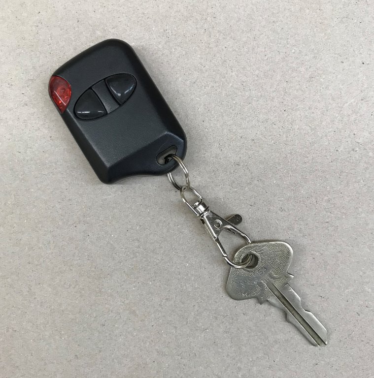

For kicks awhile back, I combined the old with the new and added remote starting on one of my Ts.:shock:
The T already had a starter solenoid/push button dash switch installed, so it was fairly easy to do.
Parts needed were a key fob and receiver, a 6 to 12v converter (to power the receiver), 2 relays and the
starter solenoid.
Remote starting a Model T works best when the engine is warm and does not need choking or carb adjusting.
The mag key is always left on. One button on the key fob starts the engine and the other button grounds
out the magneto and shuts the engine off. Works from 100 feet away.
Not really that practical, but is oftentimes amusing.:D

"Not really that practical, but is oftentimes amusing..." Zombie T! " (Just don't forget the parking brake, or it might leave without you)

Good point. I keep a water pump handy to chock it with.
