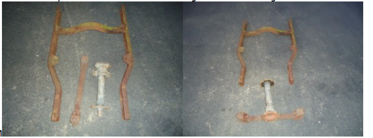

Frank's second photo of the green frame is the one I extended on my 1917 shooting brake, rather than cut the driveshaft and radius rods. I joined two frames rather than add in a piece and have two joins each side. The frames were cut at 45 degrees to give a better joint. There is a flat plate inside each rail to reinforce the frame. It is riveted at the body mount brackets and the running board brackets, as well as either side of the welded joint. No good frames were wrecked in the process. One had already been cut and the other had a damaged front cross member and left hand rail.
