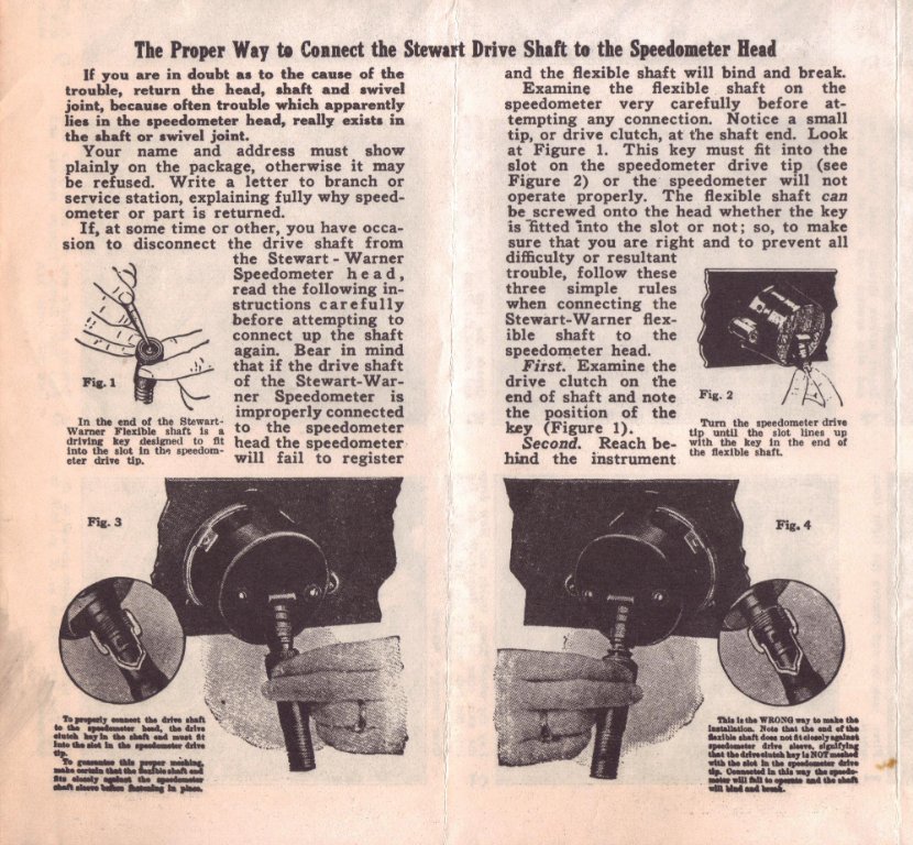

Steve, Here is the way Stewart Warner showed how to mount a speedometer. I know you purchased the speedometer, unrestored, from me, but I don't remember what swivel mount you have. PM me and I will send you a copy of the mounting instructions I wrote which should help. I know this installation is for a later car, but the swivel mount might be the same for your car. I hope this helps, Russ Furstnow

Thanx, Russ. I will send a photo of the swivel.
Topic author - Posts: 7395
Re: How should this speedometer be installed?
PM sent. Forum email won't take attachments.
