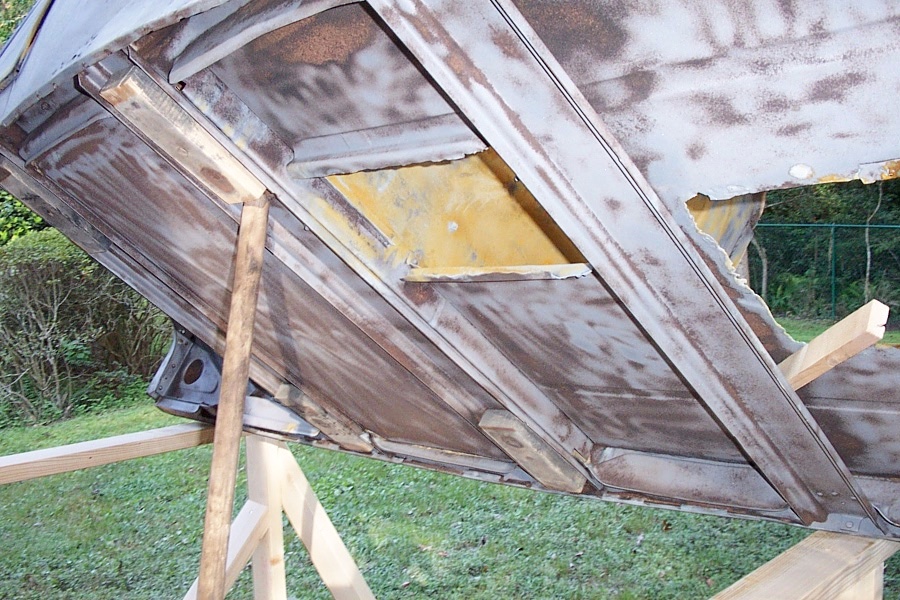

Does anyone have pictures to show how the battery cover fits? I have a replacement cover that a bit too wide to fit the indent in the headboard. I intend to trim about 1/4" off of each side of the cover where it is too wide. My question is, what holds that cover in place? Does anyone have any pictures?

Post by DanTreace » Mon Mar 18, 2019 9:10 pm
The battery door (lid) lowers into the sheetmetal framing for that door that is part of the runabout rear deck. Same as the runabout with a turtle deck. The pickup bed replaces the turtle deck.
This photo shows underside of the rear deck, you can make out the frame edges bent into the sheetmetal for receiving the battery lid. Cutaway is the metal plate due to rust out, that plate covers the rear crossmember.
The pickup bed uses another plate held to the wood bed by rivets into a pair of the metal bed strips that fasten the wood boards. That plate covers up the hump plate of the rear deck sheetmetal.

Post by Original Smith » Tue Mar 19, 2019 12:12 am
Be sure to use Southern Yellow Pine. The battery trap door is a snug fit, and is exactly the same as a 1925.

Post by gcomo » Tue Mar 19, 2019 12:49 pm
Thanks guys. My truck doesn't have the sheet metal frame for the cover. I will make some.

Post by Original Smith » Wed Mar 20, 2019 10:52 am
On my '25, I'm pretty sure the battery box trap door lays on the floor of the rear deck.
