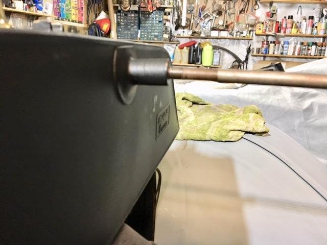

My '15 radiator rod receiver has been slightly bent upwards from a previous owner, and before I do anything I wanted to ask the pros about strength of this part? What is the best way to bent this down ever so slightly to accept the radiator rod without sripping nor doing damage, or breaking the solder?
In the pic it looks almost straight, but it is indeed bent upwards a little.

But if it were mine, I would find a bolt 6" long, thereabouts and gently push down on the bolt while tapping with a rubber mallet, just below the mount.

Short answer is there should be enough strength there to allow for a little movement. The rod on my 14 needed a little "adjustment" also, but I decided to try a combination process. After bending the threaded boss a bit and getting it closer to right, I then adjusted mostly the rod itself Be sure to keep checking hood alignment and fit during the process. As you tighten things up you will notice the gap between hood and radiator or will change.

The original receivers were an iron casting. There is a chance it may have rusted thin, and a chance of it breaking if levering is somewhat enthusiastically. Reproduction radiators/parts I have seen are brass castings and will be more resilient to being bent around. Properly installed, you are more likely to distort the brasswork in the tank than bend the cast receiver. Either way, that washer/plate around the back of the receiver may end up with a cracked solder joint. It's an easy fix once you have the receiver aligned.

Allan, the radiator is a reproduction from Brassworks.
