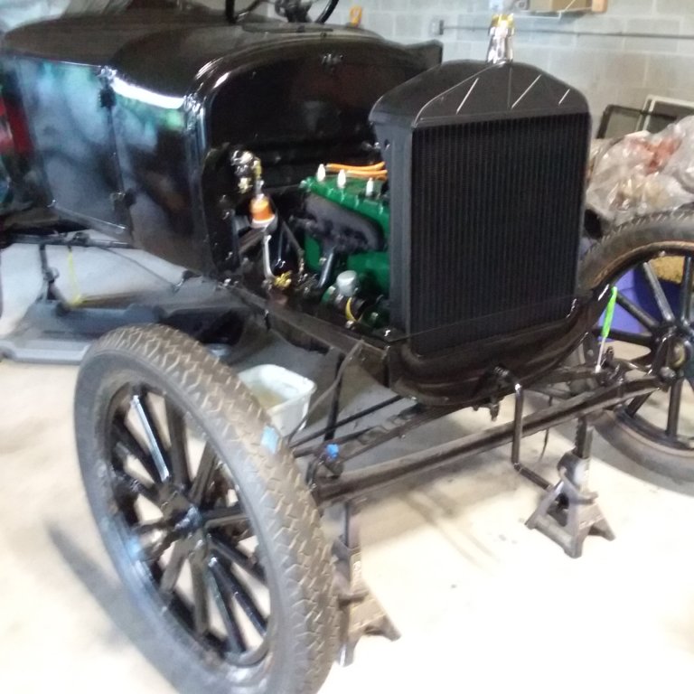

No wonder you're having trouble making things fit. Your engine is the wrong color.

I picked "snot engine green" accidentally on purpose. Although I wanted the darker forest green, the store only had this horrible shade when I needed paint.
Here are some pics of my '26 speedster project. [/size]
