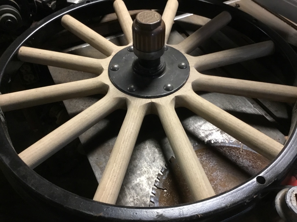

I forgot the Pic.. Here it is..
Thanks..

Cutting spokes is one of the most boring jobs I’ve ever done in my life. But call me if I can help with questions, Bob at 903-824-1949.[/attachment]

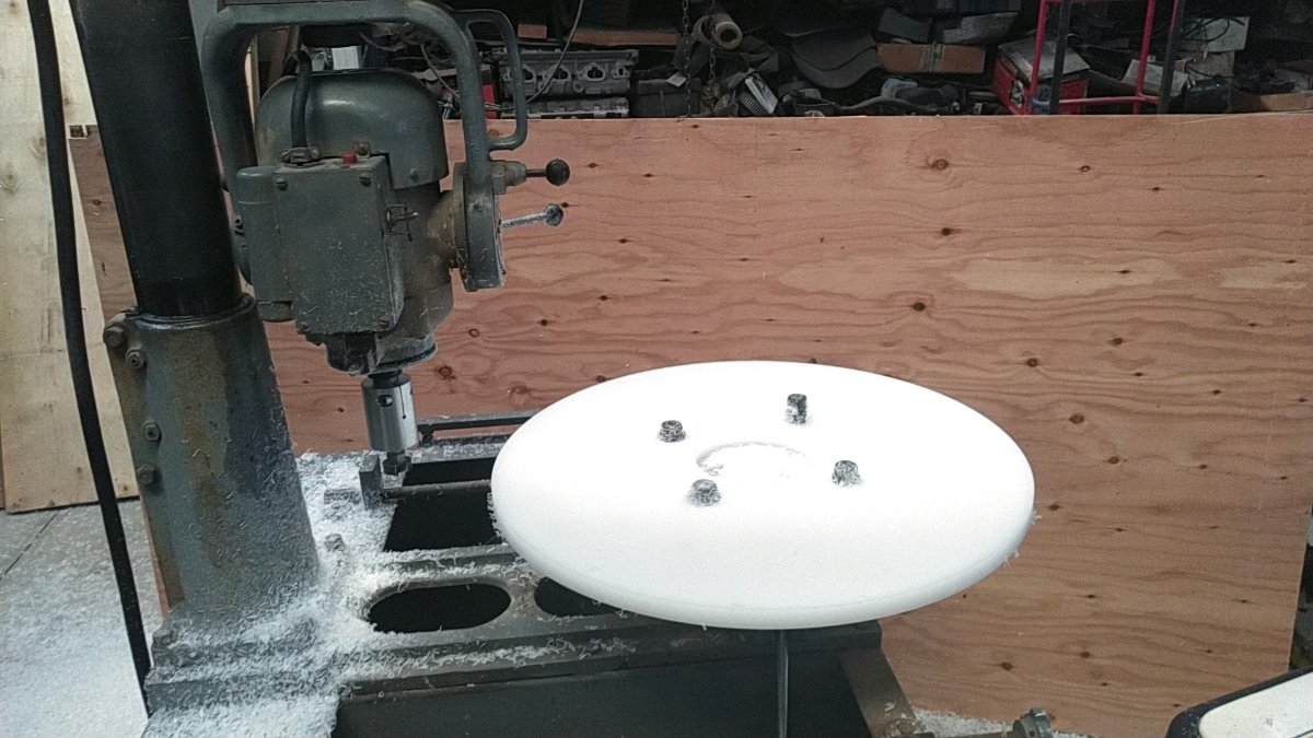

Hey Bob:..
Nice Tooling.. I love to watch 'How it's Made'.. To see the Tools that Make the Things..
Presently I'm Stumped on Putting Good Wood in Bent Felloe's in Someone else's Car.. Just looks bad to the Reputation.. I Found http://www.woodwheels.com/contactus.html that says he can Straighten and Re-Spoke.. I Got a Contact E-Mail in to Him, to see what is up..
Now for the Spokes on my 25 TT C Cab Project Truck in the Back yard. Think I might pester you there.
Been working on the Larger Turn Table for my 'Radial Arm Mill Saw' so I might be able to tru up Spoke-to-Hub Surfaces on the Rest of my T Wheels..
Thanks for Posting..
Cap

I am not a Wheel-Wright by any stretch of the imagination. I have never done a wood felloe wheel. I have respoked 6 wheels in my life. IMHO the tooling is the key to repeatability and repeatability is everything. I’ll gladly share what I’ve learned. Call if I can assist.

This took most of 1'0' X2" X8" Hickory plank to make these: ( and that aint cheap)...but a lot of fun

By Cutting the 'Taper' Last, you can make the Spokes any length you want..

Cutting the hub angle, Cutting the inside radius, the template the lathe follows, the little jig to establish center of the tenon end.

Ends up I have TWO kelsey Fellows, and Two Hayes Fellows..
The Rims interchange between the Two Different Mfg.
I was able to get a bunch of 'Kelsey Hayes' Spokes and get them all Varnished up.. Actually used Urethane.. Four Coats Sanded and Steel Wooled between Coats..
I used the John Regan Spoke Press and Put together all four of the Fellows after I had them Sanblasted and I painted them.
I ended up choosing to 'Silver Solder' closed the 'Oversized' Fellows Holes.. I had rounded them up to, and I tried four of the 'Did not pass the QC Test Spokes' that I had prepped up.. And per Scott's description they went in too easy.. To fix that I silver soldered them a little, then reamed them back out to .500. I took 12 spokes and did a 'Do or Die' trial.. They were .555 tenons in a .500 hole . It was a fight, but based upon the description that Scott gave, it felt correct.
I pulled all 48 spokes in and they are now on the T.

Cap, the second photo is of a the Kelsey felloe that is supposed to take loose lug rim. That slot pressed into the inside diameter of the felloe is the land on which the longer leg of the loose lug engages. The depression in the outside of the outer edge of the felloe is not supposed to be there. It has been caused by the incorrect fitting of a Hayes fixed lug rim. The 'foot' on the Hayes lug has been forced over the felloe, and likely the rim has stood off the face of the felloe rather more than it should have. For such a combination to work, you would be heavily relying on the four lug bolts retaining tension. The rim will have no contact with the felloe other than at the jammed feet .
In a correct set-up, the Kelsey loose lug rim wedges onto the outer land on the felloe all the way around the wheel. All the four lug bolts do is hold that wedging effect.
Likewise, on a Hayes felloe, the rim is designed to wedge on the inner land on the felloe, the four lug bolts just maintaining the wedging effect.
It is this wedging effect which transmits the drive from wheel to rim/tyre. It is this wedging effect that is compromised by the incorrect mixture of incompatible parts. Sure, they will 'work', in some circumstances, but in others they can be dangerous. Mixing loose lug rims/fellos and fixed lug rims on the same wheel is one of these circumstances.
Stay safe.
