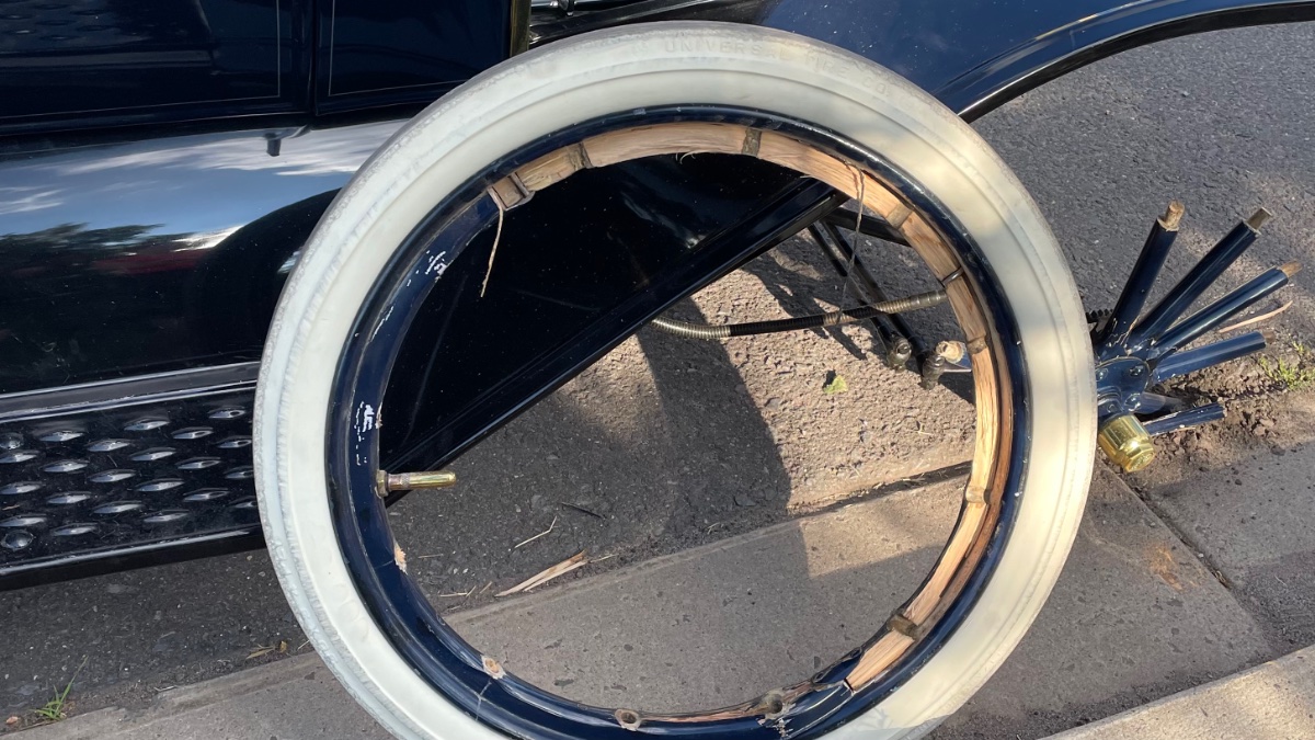

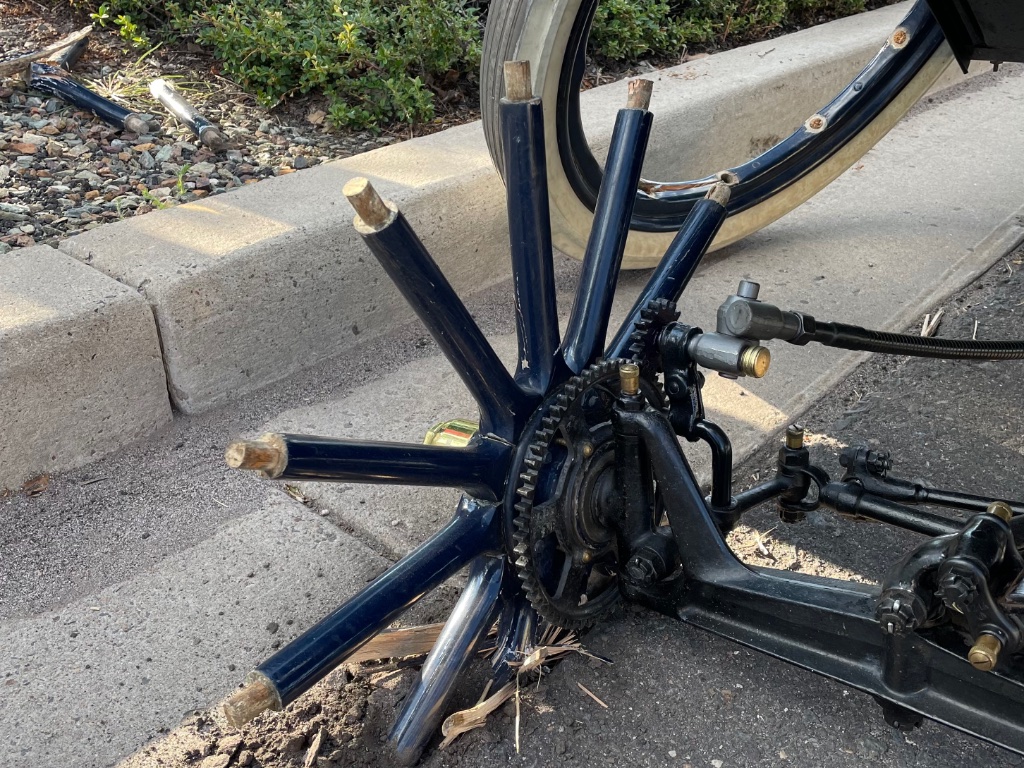

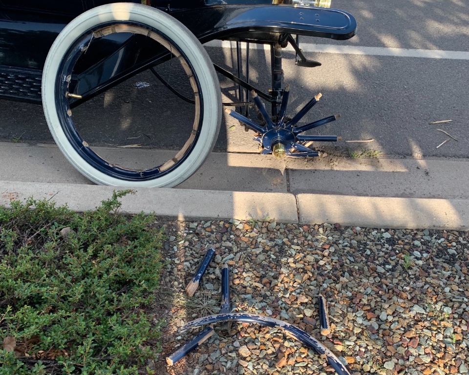

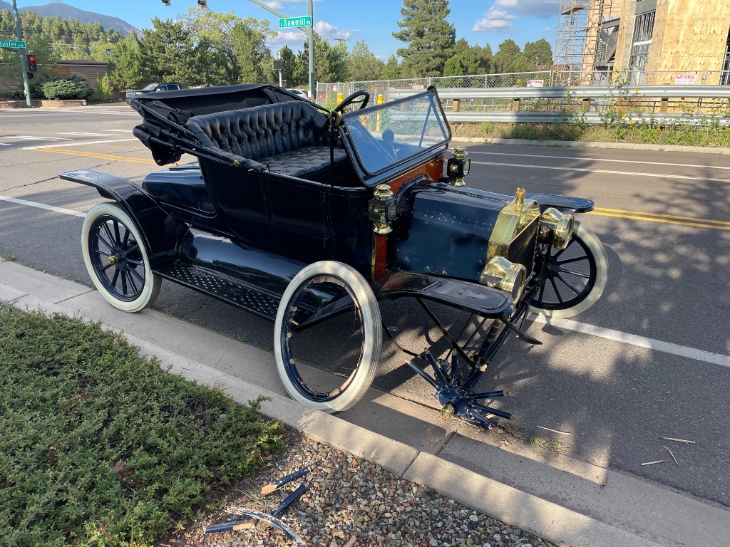

I was driving a new to the family Model T today and the right front wheel collapsed while making a left turn in a busy intersection . Thankfully no one was hurt and the car was not damaged. The wheels appear to be originals that had been “restored”. This incident could have been much much worse! Make sure you are checking your wheels or better yet have them rewooded by someone that knows what they are doing. I have used Stutzmans Wheel Shop and am extremely pleased with there products. Be safe out there![image][/image]

Looks like one felloe split down the middle. Do you suppose they used oak instead of hickory?

I would sure like to see a really good analysis of what gave way first and led to the full failure!
Very odd how that felloe split. I have seen broken felloes before, but never anything like that!

First of all, I thank God you are OK and the damage was minimal. Could you post a photo showing the inside of the piece of the separated fellow that is on the ground and another of a close up of the dark elongated spot on the bottom of the wood still attached to the rim. I suspect this might be an area of concern to determine part of the cause of the failure.

The split felloe piece shows staining at the rivet at its mid point, suggesting that a crack has developed from that rivet over some time. Old wood loses its strength over time, just as old bones do! Having dried out and becoming more brittle over time, it is more likely to let go under stress.
