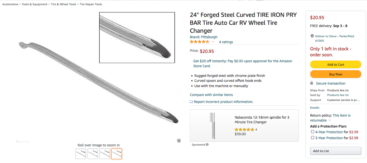

The type of tire iron you want has a curved cup on it like this one: https://www.amazon.com/Forged-Steel-Cur ... B01LZG3EVK
Once both beads are released from the rim, and two clamps have been applied like I stated above, the iron is forced under and past both beads and the entire tire (both beads) is levered off of the far side. Installation is pretty much the reverse, only easier with new tires and lubricant. You never want to do one bead at a time, even with the little short irons used in the '20s.

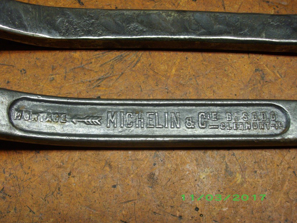

Re: Tire change tool, what do you use?
I Use this tools .
Toon
Toon
- Posts: 6803
VERY nice tools Anthonie!
