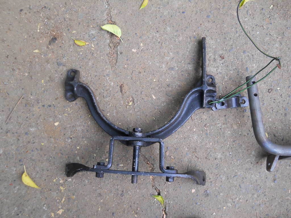

All dimensions are approx. 11" across, 4" from top clevis hole to center of parking brake cross shaft, 6" to center of sliding crossbar. Tab to mount equalizer, 2 1/2" flat stock by 4" long. Equalizer bar 10" center to center for clevis pinholes 1-1/2" flat stock. I bent the ends down on the first ones I make, but found worked just fine leaving flat. For the adjustable rod between the brake pedal and equalizer, notched it using a saws-all to fit the clevis I was using, allowing a bit of wiggle room. For mounting to parking brake cross shaft, U-bolts were used. Do not need an eazy-slider with this setup, it clears the pan and dip in the parking brake cross shaft, so does not move the brake pedal when parking brake is applied.
- Posts: 5438
Re: 26/27 Brake equalizer kit - RHD?
The force torque should be about the same as the equalizer sold. Mounted on the car;

- Posts: 5438
You are welcome. Love that word, "Brilliant", it can be used in so many ways!
or
- Posts: 5438
Forgot the thickness of the flat plate, I used 1/4 inch. For the bolt at the equalizer, I used 1/2 inch fine thread with unthreaded shoulder and bronze/brass washers between, drilled and locked with cotter/split pin.
