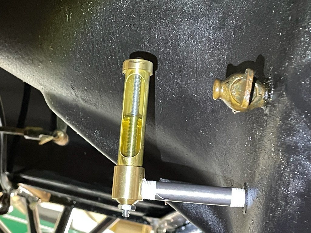

I have two of those units on my cars and they work quite well. What you need to do is drill a teeny tiny hole in the top of the cap so that the oil equalizes in the tube. By teeny tiny hole I mean the type of drill bit that folks use to build model trains. You will have folks probably come on and tell you that the next rock that goes underneath your car is going to break the glass and drain all the oil and you were going to ruin your engine. What I did was take the glass out and substitute plastic tubing. I have been using them for over 20 years and I’ve had no problems.
It’s too bad they have to be modified with the tiny hole and plastic tubing but it is what it is. Mine were free in a box of spare parts so I paid nothing to begin with.

Michael, I like that APCO unit, but there is a small metal strap missing in your photo. That pipe will fatigue and break over time. The unit is too heavy to be without it. The metal strap attached it securely to the pan bolt. If you cannot find a pic, I’ll do some digging.

Thanks for the heads up… I had no idea there was a strap. Most have probably been thrown in the trash because they look like spare bent metal for no particular purpose. I will make one from “plumbers strapping”. I’d bet no one under 60 years old knows what plumber’s strapping is……Dropacent wrote: ↑Fri Sep 10, 2021 1:14 pmMichael, I like that APCO unit, but there is a small metal strap missing in your photo. That pipe will fatigue and break over time. The unit is too heavy to be without it. The metal strap attached it securely to the pan bolt. If you cannot find a pic, I’ll do some digging.
