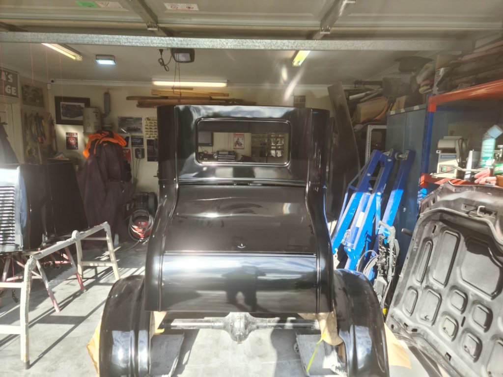

Post by Myxr6turbo » Wed Sep 15, 2021 5:54 am
Here is yesterday and today's progress. Im happy considering it's first spray job.This is before a final rubdown and last coat.
Big big thank you to Luxford for his time on Saturday on the phone. What a wealth of knowledge.

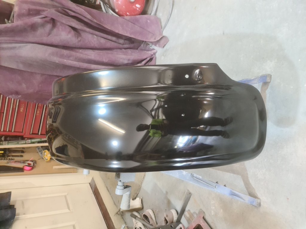

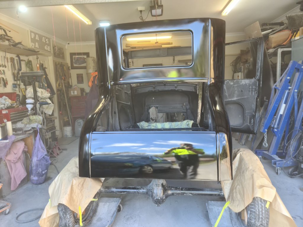

Re: Paint
Post by Myxr6turbo » Wed Sep 15, 2021 6:00 am
A few more.
Luxford
Posts: 293
Joined: Wed Jan 23, 2019 6:30 pm
First Name: Peter
Last Name: Kable
* REQUIRED* Type and Year of Model Ts owned: 1911 Town Car 1913 Speedster 1915 kampcar
Location: Australia
Re: Paint
Post by Luxford » Wed Sep 15, 2021 7:19 pm
Hi Shawn,
Just noticed your post.
Congratulations, full marks, wish all my students listened as well as you have.
email first part, pskable@
Posts: 7130
Re: Paint
Post by Allan » Fri Sep 17, 2021 3:36 am
Nice job Shawn.! :D You should be grinning from ear to ear.
