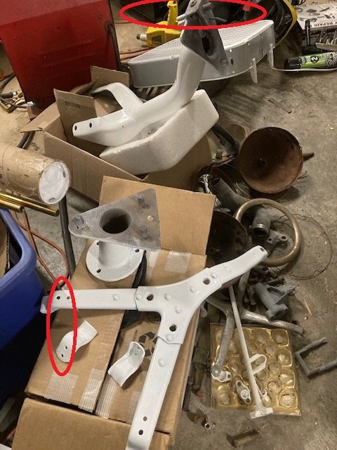

The parts were scrambled when this went to the painter and I may be missing parts. I am wondering how this goes back together? The forks go onto the rear spring U bolts, then the Y shaped part goes face up on the triangle mount? The two brackets go on to the top of the Y? What fastener attaches the two brackets? What goes on to the bottom of the Y? Am I missing a part? What does the seemingly extra short tube part do? The two bolts in the second picture do not seem original they seem to be an odd fit. I am unsure what that flat piece and sliding bolt do?

Yes, Ignacio, you appear to be missing at least two, maybe three or more parts. Lang's has all of them listed in their catalog. Part # 2876 B are special nuts used on the 3 threaded bolts on the gooseneck carrier to attach the 'Y' to the gooseneck. Part number 2849 B is pare tire carrier clamp bolt. Part number 2849 C is the spare rim carrier bracket. Part # 2849 D is the spare rim carrier outer clamp. Other parts that may be needed are 2848 B, 2875, 2876, or 2876 B.

The extra short tube you do not need. Three bolts go through the gooseneck and like Terry said you normally use three nuts to hold the Y on. They are special nuts that fit in the gooseneck. The small parts go on the top Y portion of the gooseneck. Terry listedwhat you need for the bottom.

I am wondering what does the red circled amalgam of stuff do? It looks a little odd like some of the bolts are not original. Internet pictures don't show this gizmo to be present. Secondly internet pictures seem to show the brackets are riveted but these are not. While I can rivet I don't want to mess up the paint job on this so I am thinking of bolting the brackets on?
Thirdly Lang's has 2 types of lower bracket: https://www.modeltford.com/item/2849C.aspx and https://www.modeltford.com/item/2849D.aspx do I need any of these for this or does the stud just go into one of the rim bolt holes?

The piece in both photos attached to the triangle needs to be discarded. It does not belong there.

Ignacio, The gooseneck touring car type spare bracket uses three studs like the ones on your roadster type bracket plus three special nuts to mount the Y bracket. The other stuff is not stock and not needed. At the top of the Y the rim retaining bracket was originally riveted on, but in your case of final paint already done, you can use button bolts that will look a little like rivets from the front side.

On my carrier the upper brackets are riveted. The bolts for the triangle normally take a thin nut that is tapered on one side. They did not work on my carrier so I had to use the thicker tapered nuts. Hope this helps.

It is on! You do have to back out the U brackets all the way to get them on. Getting the cotters off, backing the U's off and putting them back on was work but the cool factor of the tire carrier is off the charts. Lang's is out of the lower stud so I am using a rim bolt temporarily.
