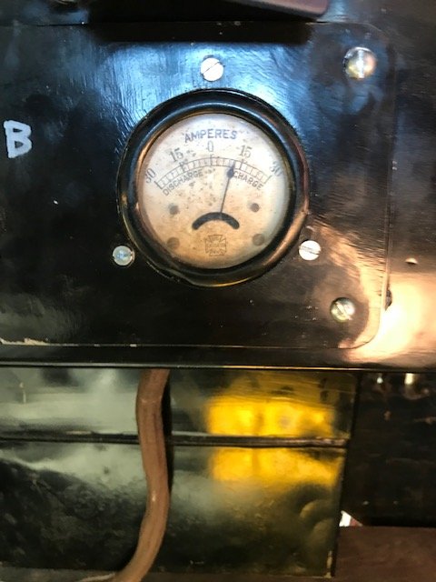

My generator seems to be charging too much. I don't want to burn it out or damage my battery. It is putting out 9.3V and 13A on the dash gauge at a high idle. I've moved the 3rd brush all the way away from the engine (opposite generator rotation) and it seem to make no difference. Am I missing something? I have a solid state cutout and a 6V battery. When I turn on the headlights it goes down to about 3A on the gauge.

Have you calibrated or compared your dash ammeter to a more accurate one?

well I had a chance to work on the T today and attempted to adjust the generator with the Ron Patterson method as he suggested. With car switched off the battery was at about 6.5V. I backed off the 3rd brush (opposite direction of rotation) and loosened the four screws holding the brush plate. With the engine running above idle I moved it back and forth while watching the Ammeter with a mirror. I never got it to go below 10A. Then I did the same thing with a volt meter (both digital and analog) and never went below 9V. Checked at the battery - 9V. I'm stumped. Moving the brush holder has no discernable effect that I can see. What am I doing wrong?

I tested the voltage at the generator post (both sides of the cutout) with an analog meter. I just tested at the battery to make sure I was getting similar voltage there in case there was some connection issue. It reads 9V with analog or digital meter.

Today I started the car, no chrging at all. First I checked the wiring at my switch. All OK. Checked the wiring between the generator and the terminal block to the ammeter - OK. Checked the wire from the battery to the ammeter - OK. I pulled the generator and set the Null point. It ran like a motor with the third brush pulled up and not contacting so I set it so it wouldn't run either way. reinstalled it with the third brush at the most retarded point. Started the car. no voltage. moved the third brush and I could hear it loading up. checked the voltage: 9.5V. moved the brush back to the most retarded position: 9V. Then my Ammeter stopped working. Doesn't move either way when I start the car, or when I turn on the headlights. $%$&%$#@!!!!! Now I can't even see what kind of Amps it's putting out. Guess I'll go to bed and try again another day.

Your symptom of no charge, moving the 3rd brush, finding a point that charges is a classic sign of a bad insulator behind the 3rd brush carriage bolt. It will need to come apart to replace the insulators. This the most common problem with a T generator.JamesD wrote: ↑Tue Sep 21, 2021 11:05 pmToday I started the car, no chrging at all. First I checked the wiring at my switch. All OK. Checked the wiring between the generator and the terminal block to the ammeter - OK. Checked the wire from the battery to the ammeter - OK. I pulled the generator and set the Null point. It ran like a motor with the third brush pulled up and not contacting so I set it so it wouldn't run either way. reinstalled it with the third brush at the most retarded point. Started the car. no voltage. moved the third brush and I could hear it loading up. checked the voltage: 9.5V. moved the brush back to the most retarded position: 9V. Then my Ammeter stopped working. Doesn't move either way when I start the car, or when I turn on the headlights. $%$&%$#@!!!!! Now I can't even see what kind of Amps it's putting out. Guess I'll go to bed and try again another day.![]()
You could use a separate, modern ammeter to more accurately read actual output. The in car unit was good for reference of activity. The high voltage reading is still telling me there is no battery connection(open) or possibly an internal battery problem. Keep picking @ it.
