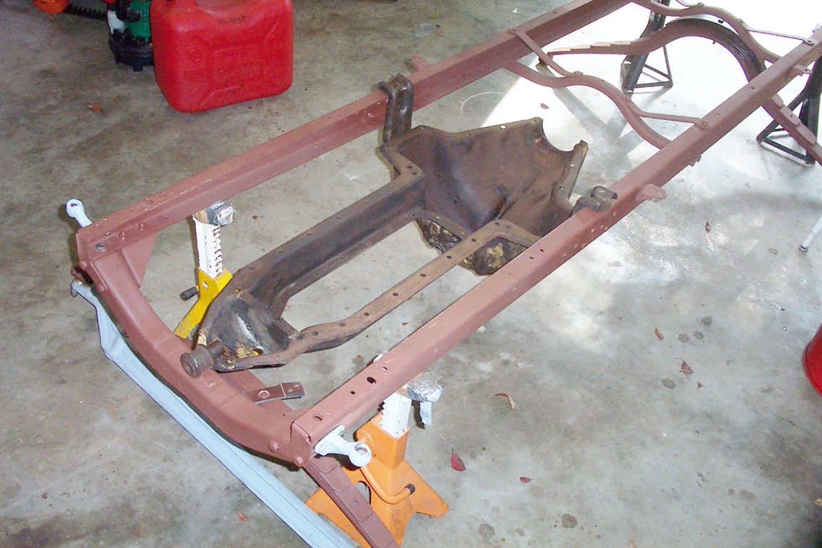

I'm trying to come up with a way i can use pre '26 headlights on a '26 frame.
Anybody have some pics?
***planning on using pre '26 headlights and mounts.

My '26 will be clean with no fenders. That's why I need the earlier brackets that mount to the frame.
I have to clear a lot of extra metal up front at the bottom of the radiator in order to get a clean install.
I'm hoping somebody brainstormed a good way around '26 frame obstacles.

Brackets aren't the issue.
It's the attachment of bracket to frame that interests me.
I'm using pre'26 headlights and brackets

There you will see photos of amputated frame horn for the '26-'27 fender mount. Then drill holes to mount the earlier fender/headlamp bracket. Cut of the fender iron to suit, just above the lamp mounting hole.
Photo of cut off pre-'26 fender bracket to mount just the headlamps.
