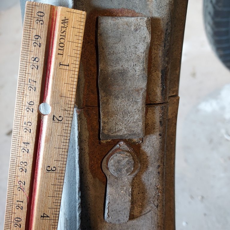

Am requesting information on firestone split rims. What I need is the dimensions of the clasp which holds rim together. It is two pieces, one is a rectangle and the other is an arrow which pivots on a pin.

This should help you out. Play with your printer scale to get the ruler to measure right and you will have a full scale template.

I don"t know how to do that. But, will give it a whirl.

No way, printer scale! Can't get it done. Any others have a thought?

Scale it manually. Put a measuring device to the ruler shown. Do some division for a conversion ratio. On my monitor the 2" ruler is 2.050" Near enough 1 to 1. So the bar is about 2 3/3 long. The lock is just under 1.75" long

I'm a genius! John and Jeff much appreciated. Many thanks.
