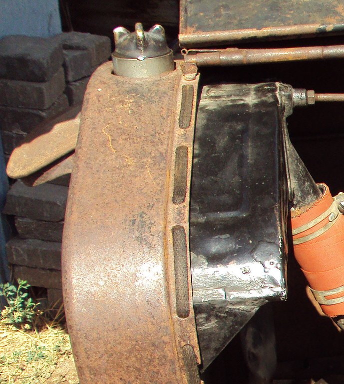

Post by Rich Eagle » Sat Oct 09, 2021 1:38 am
This is the radiator I put on my '22 Coupe. The neck is the same diameter all the way to the tank. It is a low one and one of the aftermarket replacements. Some may recognize the neck casting. I would replace it with one with the proper neck but it cools better than any others I have.
It is tube and fin but I have some cellular radiators with similar necks.

Re: Odd Radiator Fill Necks
Post by ModelTWoods » Sat Oct 09, 2021 1:47 am
Rich, the radiator that I have, and the other one that I've seen, both have a straight neck like the one that you pictured, so maybe mine is an aftermarket. I just assumed since it was a two row flat or oval tube, that it was one of the rare 26 radiators. The neck is crimped to the top tank. I can't tell if it is also soldered. If it is, its a darn neat and nice soldering job.
