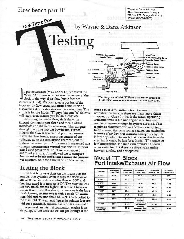

Post by old_charley » Sun Oct 10, 2021 4:59 pm
Here's some carburetor and manifold flow info. Hopefully we're not running afoul of copyright law.
