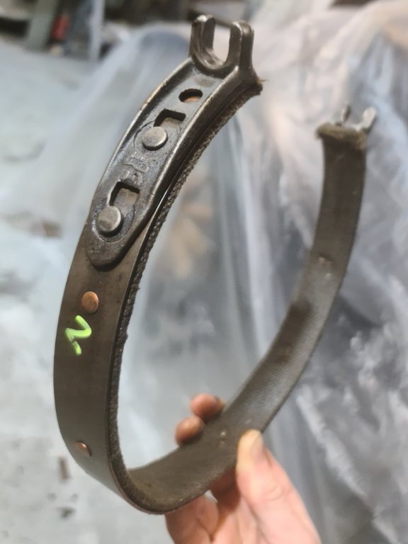

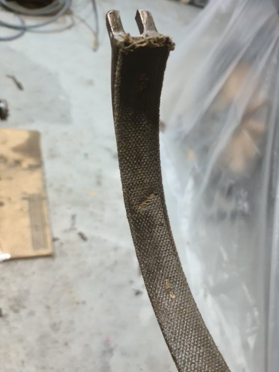

Here is a photo of the low drive band. Looks like the lining has been replaced. Not what with though.

Shawn, if you look closely at that lining you will see that it has not been engaging the drum where it is worn, indicating that the drum was gouged before that lining was fitted. I cannot imagine how the gouging was done. Usually it is due to the rivets in the linings, but it is then fairly well certred on the drum.

Are the bands still usable and what material are the bands?
Posts: 5599
Re: Lip on middle drum
Post by RajoRacer » Wed Oct 13, 2021 10:09 pm
Those linings appear to be later production Scandinavia as the weave is "square" - the proper rivet technique is that they should be spread across the lining - not in line.
