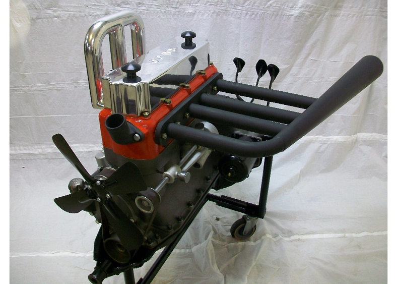

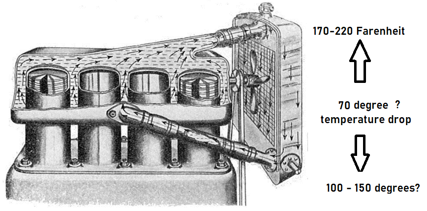

How much HP will the thermosiphon handle?
We all know that a well working Ford thermosiphon system will easily dissipate the heat from a stock 20hp T engine. Switching to a new flat tube radiator adds cooling capability that can handle most flathead upgrades like a performance cam, carb, and higher compression, which typically work out to be 30hp or less. Once you get to a overhead valve set-up and the engine can generate 40hp or more, at what point is a water pump or other significant cooling upgrades needed to keep up with the extra heat?
I believe that most Rajo, Fronty, and Gemsa equipped engines have/had waterpumps.
Eric
Eric

It really isn't a question of thermosyphon versus a water pump. The beauty of thermosyphon is that the more power from the engine? As long as the radiator can handle the heat dissipation, ambient temperatures etc, the faster the thermosyphon will move the water! The limiting factor really is the radiator. Brass era radiators are the smallest. 1917 through 1923 low radiators are better, but still a bit small. The 1924 through 1927 full thickness core radiators are the best for heat dissipation. And as you mentioned, the newer flat tube cores also help.
Honeycomb type radiators can be either better of worse depending upon specific designs and water capacity of the cells. Honeycomb radiators are also much more prone to passage blocking within the cell structures due to rust or hard water. They can be very difficult to clean out if they have been badly plugged.

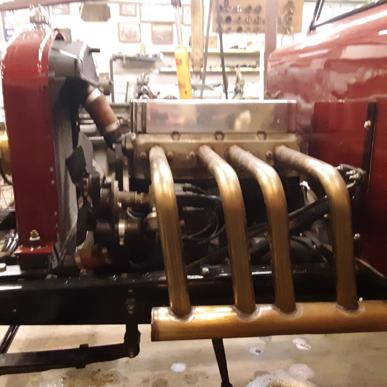

Perhaps true, but not really what we’re discussing. Since this problem has been solved many times before and not wanting to re-invent the wheel, I’m looking for the voices of experience to share what has worked and what hasn’t.TXGOAT2 wrote: ↑Fri Oct 22, 2021 2:16 pmIdeally, a hot rod T would have a water pump that pushed water into the water jacket inlet, a thermostat with bypass, and a radiator of adequate capacity that could be run with a 13 lb pressure cap. A water pump of sufficient capacity would probably require a v-belt or modern type belt drive. About 1,000,000 variables would impact exactly what the ideal setup for any particular build would be.
My ‘27 Runabout with a Rajo B, Winfield S-1-BB, and full pressure A crank came to me with a water pump of sufficient capacity with no pump belt, a Three-in-One front plate as seen on pg 132 in “Model T Ford in Speed and Sport”. I was told that the car had no cooling issues during long climbs like Pike’s Peak, and I have observed no cooling issues in my neighborhood of 8% grade hills either.
But for my next build, I plan on using a Matco cross drive under a Bosch ZR4 2 Spark Dual and that appears to conflict with the normal T water pump installations, or maybe not. I have been trying figure out whether or not I have to solve that conflict, and the practical advice given so far is that I should count on having a water pump in my build plans.
Eric

Basically the study recommends a core value of 50cu.in. per each horsepower. Thermosiphoning radiators are usually 15% larger than pump units. Note no mention of a hybred pump/thermo system

Here is my setup. Big cam, Chaffin head, Warford with 3.23 gear. Keeps up with modern traffic, no water pump. Only heard it gurgle twice. NEW LOW RADIATOR.
