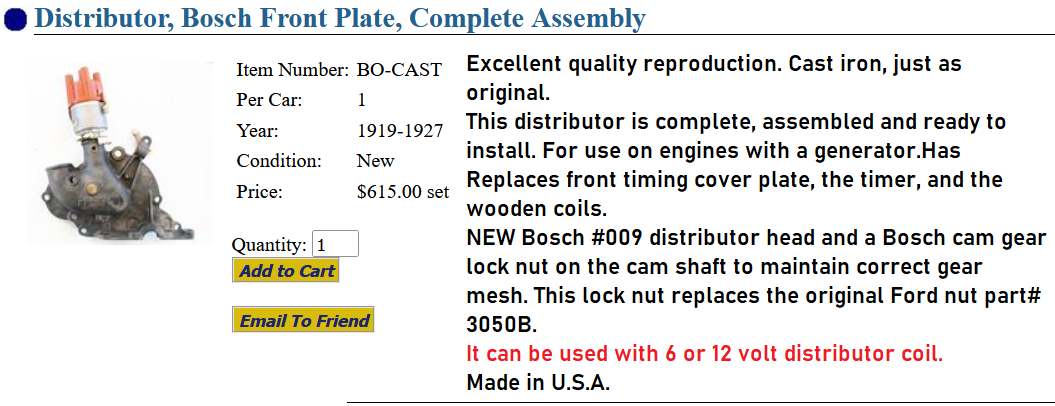

The distributor body may be able to work on 6 or 12 volt. Its the coil that is matched to the car voltage (battery). So all you may need to do is use a 6 volt coil. What model distributor and does it have points? If it has an electronic ignition module setup then it is voltage dependent for sure. Also is the coil a 12 volt - check the model # and does it require a ballast resistor? Hard to give a definitive answer without knowing what you have - generator or alternator etc
Here is an example - so what do you have?

Pertronics make all kinds of distributors so you can't assume that its a VW/Bosch or a Delco clip on or whatever. Need to know a model number, picture will help as well.
While we all agree that you don't need 12 volts, we also don't know why he says its 12 volts or has it.
"My 26 project came with a 12 volt pertronix in the distributor but I would love to run the rest of the car on 6 volt to protect the starter. Is this even remotely possible?" note the first words "My 26 project came with" doesn't say what else it came with.
