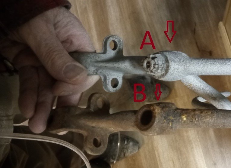

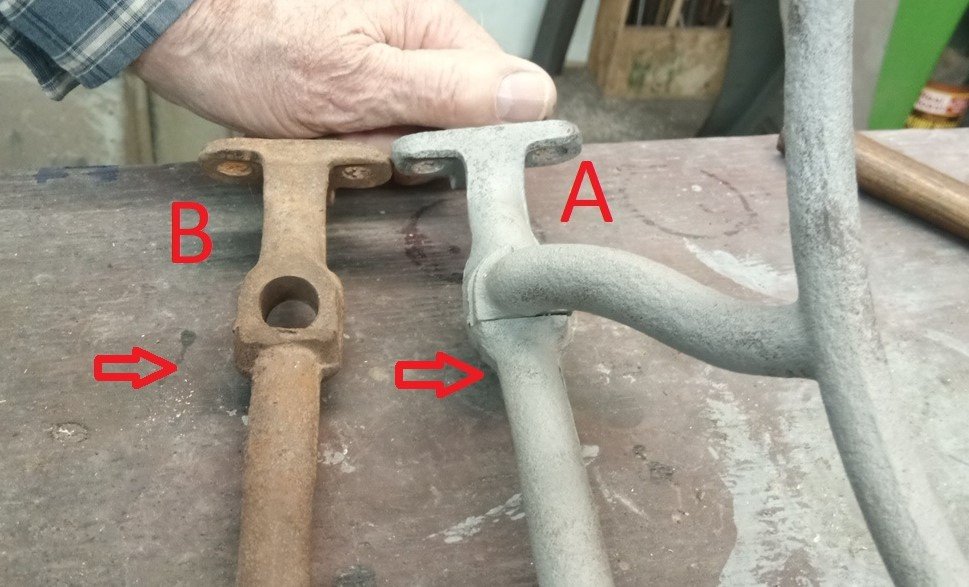

Sorry it took so long to post a reply but I was waiting for some pictures of the front fender irons I am inquiring about. I think the differences are pretty evident from the pictures and looking at the arrows. The irons I want to use are showing as "A" in the pictures, both irons are for forked mounted headlights. What years were forks "A" used on?

Can’t see the underside to show the’V’ like flange gusset, B has that.
If A in your hand has the same gusset like B, then A is ‘14-‘17.

I have attached pictures of the underside and side view. I have an original 15 chassis and the fender irons are much heftier. What about the length where the fender attaches to the iron, is iron "A" correct? It is shorter than the iron pictured as "B"
The fender irons are to be used on a 1914 Ford.
