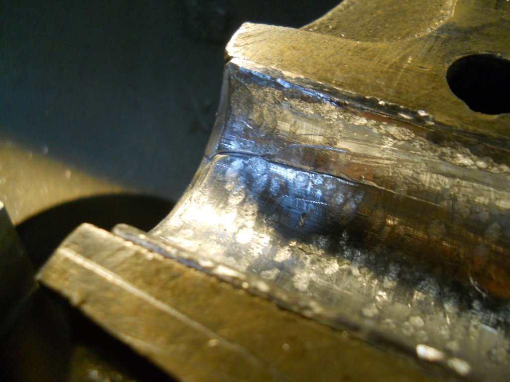

Using KR Wilson pouring bar. The areas where the Babbitt is poured has been turned down about .030. Shims added under the spacer block that fits on top.
My first attempt, forgot a plug in the oil hole, most of the Babbitt went on the floor.
2ed try, did not get all the moisture off the pouring bar. Luckily, only a small splatter hit me in the face, most went on the floor or all over the block. Lesson learned; face shield and welding gloves from now on.
My 3rd try (the photos), Babbitt at around 800 degrees with Palmer Hot Pot, block about 400. I think the pour would have been better if I had not stopped because the side I was pouring from was overflowing, also may turn the KTW collar around and just use the flat side on all the saddles. The KRW collars have a built-in radius, except for the front one. Next time I am going to barrow a set of the pouring dams.
I did get the thrust on the back side a bit thicker than is really needed, will close the gap up some. I had to use an 1.25" ID collar that I had on hand, shimmed to fill the gap on the ID, and with a piece of brass shim stock clamped on the outside to make the mold, the KRW collars have too small of OD. Using the collar I had on hand with larger OD seemed to work just fine, just clamping the shim stock on the outside, but could have a larger OD. Will get some 6061 aluminum round stock and try a different approach at some point.
I am only adding thrust to the rear of the block, so only that part was cut back on the saddle. For the caps, I will be using Gene French's mold. At this point, just I am using reclaimed Babbitt to practice with.

Re: Practice pouring Babbitt
Babbitt should be at least 950.
Remember that KRW boring jig is made for Standard cranks. You should under cut the bar to be sure you have enough material for undersized cranks.
Also you will need to peen the battitt before to cools.
Dan as usual is right on, you need to be above 900 degrees on your babbitt when pouring. Be sure to remove the dross & stir the babbitt right before the pour. You should consider milling the 3rd main on the block so you have a full thrust on the flange side of the block when you pour it too. I use to use a period Taft Pierce set up. It worked well but Gene French’s set up is a better system for me because like Dan stated your not dealing with standard size cranks. So we’ve got 2 jigs and multiple molds from Gene for faster production when doing multiple blocks. Dan also gave us some great recommendations on how to peen the babbitt but I won’t steal his thunder.
Using the KRW pouring bar, the areas where the Babbitt is poured has been turned down about .030, that is why there is a step at the rear. I may take it down a bit more.
This was a practice pour only, used a ballpeen hammer. Till I add a bigger circuit box, I can either have heat or run my air compressor to use the pneumatic rivet gun for peening. My compressor is hardwired into the only 220 CB, so have to unwire it to use the plug for the 220 shop heater. I pick heat right now. LOL
I am now thinking that the front of the saddle just was not hot enough, I will have to check that better on the next practice run.
"Be sure to remove the dross & stir the babbitt right before the pour." yes on that.
I remove material from the rear of the block saddle to match the length of the cap and angled it back some.
I use two cast ladles when pouring, that way it pours faster from both sides. The babbitt peening came into the process from Ford was pouring cold blocks and they used this practice to set the anchors. If you take two pieces of babbitt lay them on top of each other and start hammering them, after a while you still have two pieces of babbitt! Try knocking a shell out after peening, some of the anchors will be brittle and fall right out. The best way is a hot pour on block and babbitt, they will cool slowly together.
In the beginning some one told me to use cotton balls to plug the holes, I took out two light bulbs and Babbitt splattered everywhere, still have Babbitt on the walls from it. Can not have any moisture in the process. Try chalking or turn down the torch to get the black from the gas and smoke the molds so it makes it easier for removal after, do not smoke the shells!
No oil, no moisture, no rust. Virgin babbit will probably handle better than reclaim. A draft-free shop helps.
I have always wondered exactly how many pounds of Babbit are needed to complete a rebuild of main bearings, connecting rods and camshaft bearings.
Now, I am also wondering what is the ratio of elements for the safer lead free Babbit.
The genuine Ford Babbit ratios are well known, but there are several variations, all just called Babbit, available.
My very first pour was a 4th main. I smoked the mold core, got too much smoke on it, left imprints in the Babbitt! LOL I didn't have any issues removing the mold during this practice run, came right off. Putting carbon on the mold was suggested by someone else, too, when I did the 4th. I will do that if the need arises.
I am using the Hot Pot to melt the Babbitt, just don't have room for a larger pot to use two ladles, so am trying this way to see how it works.
After reading up on pouring, I was thinking that because when the KRW setup was used, the block just had the chill taken off and moisture removed, that is why the two ladle method was used, for the quicker pour.
Joe, I think I understand what you are saying re the peening.
So far, the feedback has been great. Thanks!
No oil, Check
No moisture, lesson learned check
No rust, did not see the rust on the bar which was from the 2ed attempt
Virgin babbit will probably handle better than reclaim. That would be a good thing.
A draft-free shop helps. As close I can get it, even turned the heater to blow the other way, but shop is only about 14 by 10.
No oil, Check

i recommend a material called " Anti-Heat" from Eastwood supply co. for plugging the oil holes ... this is a refractory material that is water soluble and is easily cleaned after drilling out the oil hole ... i use a 30 cal. brass barrel brush ... for babbitt on the west coast you can purchase an automotive high speed babbitt from N-F smelters in Seattle ,Wa. ( Non-Ferrous Smelters ) ... will post the numbers for the "anti-Heat" and tinning compound from Eastwood tomorrow ..always an optimist...Gene French

When I first started playing with it, I used melted out babbitt, later found out imperfection after machining, then I found Power Nickel from Magnolia metals works great and real close to the Ford original, it is pricey and it is sold on the rare metal exchange so varies every day.

Gene is this the tinning butter; https://www.eastwood.com/ew-tinning-but ... b-jar.html I was worried because it might have lead in it, so didn't know if I should use it.
For plugging the holes, I have that covered.
I have a new/old bar of "United American Metals Government Genuine" Babbitt. Last time Tom checked, the Seattle place had a really big price jump.

Another tinning compound is Tin Tight from McMaster Carr, and they sure do not give it away.

Do you guys tin the mains in the block? Ruby red is awesome for tinning. Generally speaking the fist time you have moisture on you block or caps is generally your last ha.
