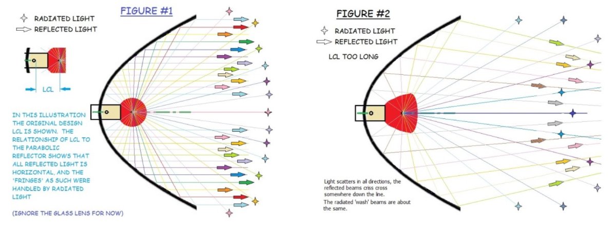

NOW the issue with headlight bulbs is that there is a difference between looking at a brighter headlight versus looking a a brighter road ahead. The reflector in the headlight has a specific focal point where the light source needs to emerge from to optimally project the light. Light outside that focal point is unfocused & dispersed broadly
Here are some diagrams to help visualize how things work
The job of the lens is to direct the light in a specific direction.

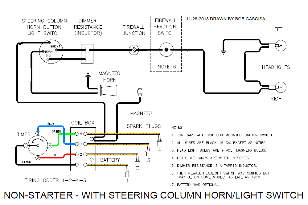

I’ve got a ‘21 I’m working on that has a generator and battery, so all of the suggestions relating to battery connections will come in handy when I start playing with that. :) :) :)
When it comes down to it, I’m an electrical ignoramus. When you speak about electricity, you have to speak reeeeeally slowly and reeeeeeally carefully. This is me when you guys are talking about electricity… call me ‘Ginger’. Hahaha
[image][/image]

Post by MadMax » Sun Nov 28, 2021 3:29 pm
I think we’re on the same wavelength (pun internet.. again). I’m intentionally running 12v (knowing they will be dimmer) so they won’t blow.
Posts: 6581
Re: Re-run On LED Headlights
Post by TRDxB2 » Sun Nov 28, 2021 5:59 pm
If you have a '15 Touring then and the 12v bulbs are dim - then its likely the '15 is wired with the headlight bulbs in series as mentioned above. So how are you wired and how will you rewire
or are the headlights withed like this
headlight in parll.png (4.66 KiB) Viewed 7551 times

I'm not sure it's the best comparison; FWIW the LED's I use are specifically for headlamps and do not have the additional light throw that would likely result from LED's such as those depicted (which clearly have quite a broad light source).
The diagram was my own making to help explain the meaning of pin-point. There are many designs of LED 1156/1157 replacements. 1156/1157 bulbs are indicator bulbs, BA15 (horizontal pins) and BAY15 (off-set pins) bases respectively. 1156 is a single action running/turn signal while the 1157 is dual action running/turn signal & brake light. The suffix applied to the base indicates the internal contacts S for single or D for double. Now the headlight filament bulbs that the vendors sell are actually 1188 bulbs 50/32 candle power. Note that the reflector is what magnifies the CP of the bulb to a 50CP bulb may project 20,000 CP and it is the lens that aims the light. Again a very bright lens doesn't mean that the light is focused, in fact if viewed from different angles the amount of difference indicates what is actually being aimed.
I have include two 1188 filament bulbs for sale. The first as its filaments one higher tan the other, while the second seams to have them more pointed and closer together. So which would be better in a Model T reflector - pointed is more pin-point. But it may be that the reflector was designed with two focal points, one for high beam and one for low as the other diagram shows. Who knows...
