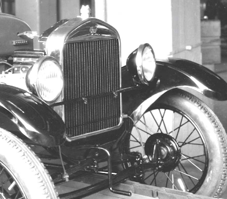

The Improved Car '26-'27 came along with improvements to assembly line too.
As for your wiring questions, the chassis was wired at ignition, and lighting looms as it chain drove down the line, note the 15th Million, coil box on engine, wires to plugs and timer already on the engine during engine drop.
The body was fitted with the switch wire loom before the body drop, as dash and switch plate were in prior.
Note the switch loom sticking out the firewall as the lighting loom headlamp wires dangle below the lamps
Lastly would be the tail lamp wire to the rear fender. Battery and starter foot switch loom would have been installed on the chassis.

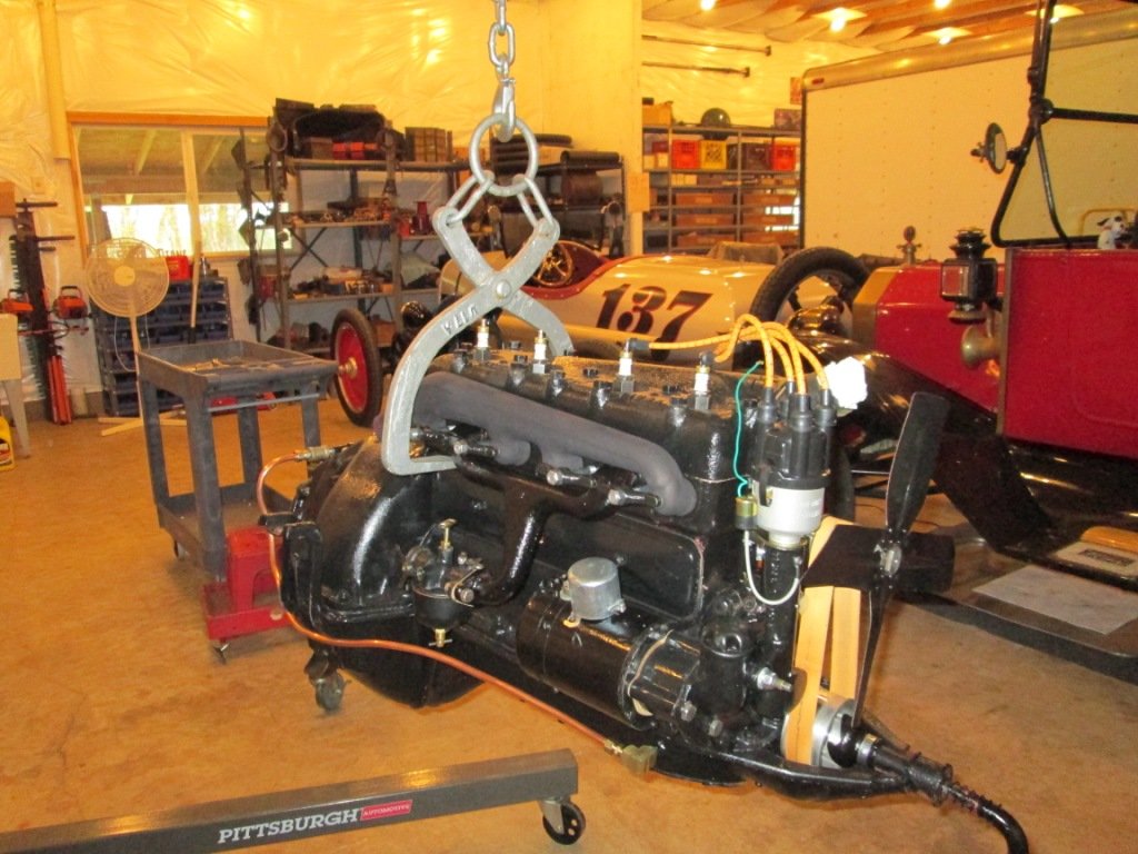

Thanks for the photos Dan ! I noticed the modification to the manifold side of the engine picker to "clear" the Vaporizer carburetor - don't believe mine will do that !
