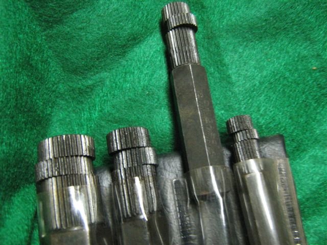

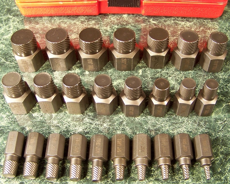

You need a pipe thread easy out set. Or a stubby set. I have to do this very often with Hydraulic fittings that break off just like your petcock. Just tap them in slowly and get a good bite and then unscrew. Works 7 times out of 10. Sizing is important

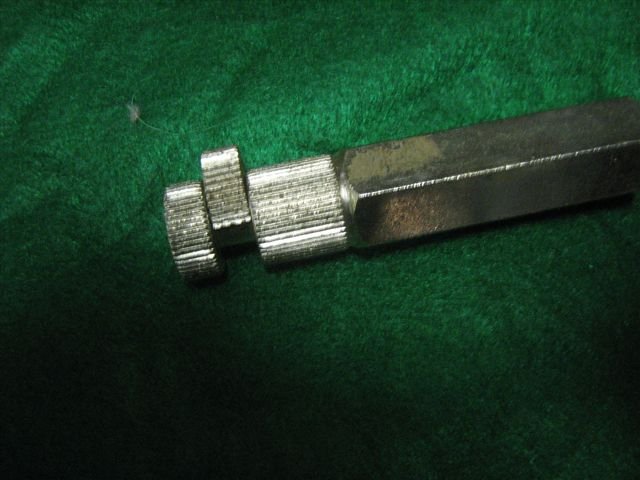

For what it’s worth if you use the easy outs shown you usually only need a wrench the size required to turn it out. If you use the proper size stubby ez out it won’t put anymore pressure on it than needed to remove it. If that doesn’t work then maybe it’s worse than we thought? Do you have a picture?

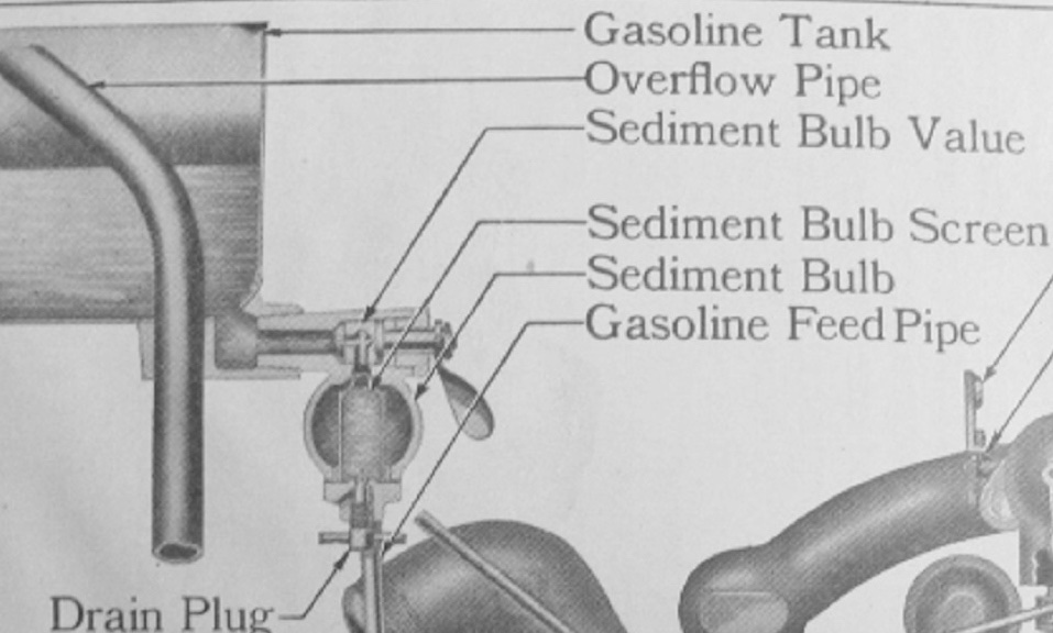

Bryant: Thanks for posting that picture as It clears up some concerns I had. Again, thanks to all that contributed ideas, once again demonstrating the quality and value of this great site. Bruce
