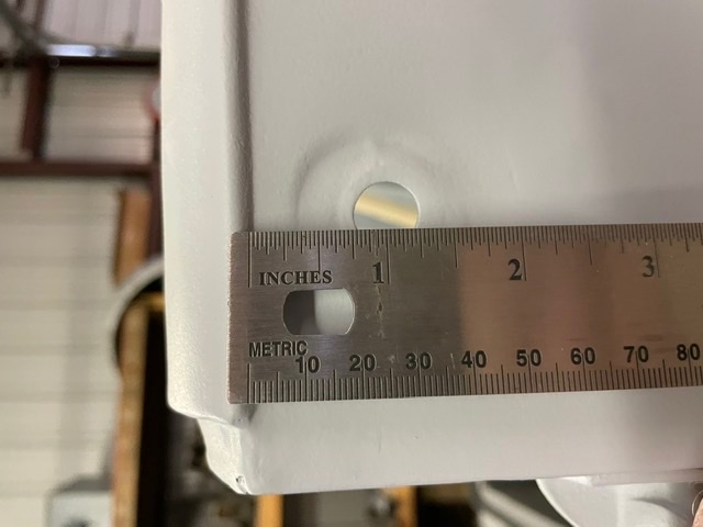

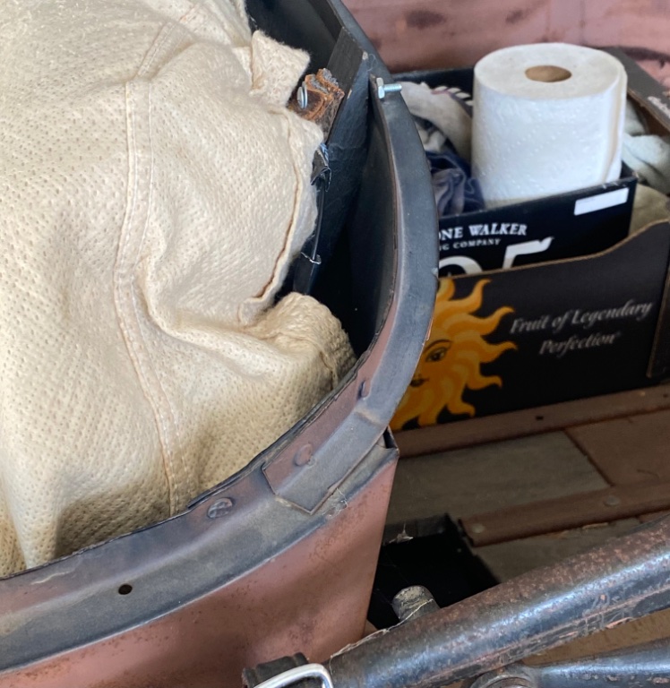

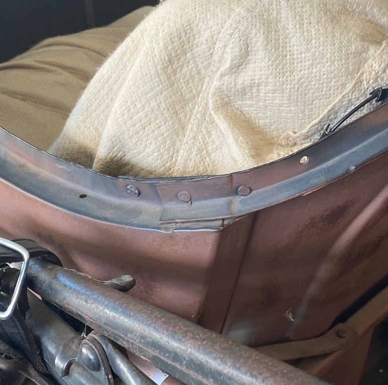

Dave - attached are pictures of my ‘26 RPU - tack strip flange and attempt to measure pivot location - let me know if you need more info. Chuck.

Re: 26 roadster top pivot location and tack strip question
Thank you , just the info i needed , will heed the advice of fitting tack strip, been looking at possibly synthetic or laminating, the picture of end profile helps a bunch. the gentleman who started on the car passed away so i don't have much reference and am missing many small detail parts, my touring needs tack strips as well. mtfca website has been great for information. Thanks

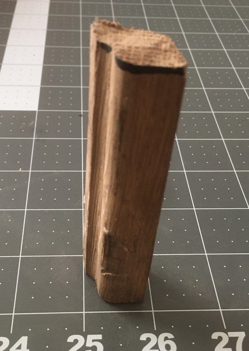

I found this today while sweeping up. Here is a steam bent wood tack strip which the supplier states is made to Ford prints. I used these on my '26 and am happy with them. The strip is not rectangular and the corners are not square. Shown on a one inch grid.
Tom Miller
