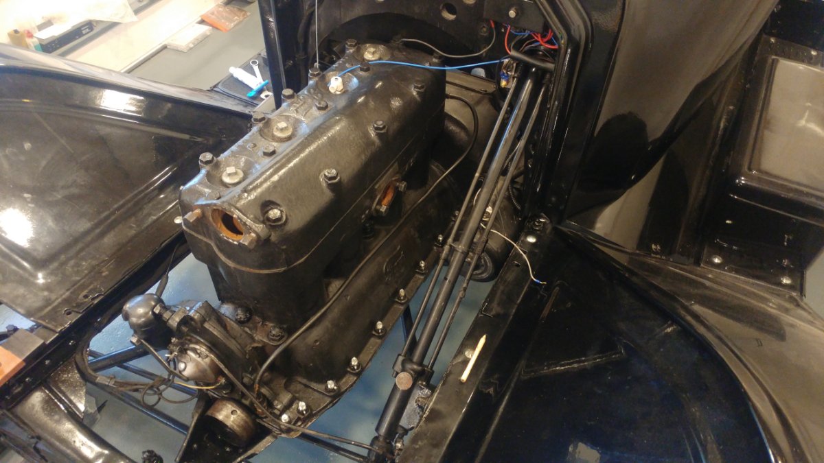

My timer - so I was told - seems to be a very similar to the original ford timer. Luckily I found a picture where it is good visible.
Here you can see the front end of the engine
From what I see in the video, I think I know why it did not start. I had the spark fully retarded (left lever in uppermost position), as I do with electric starter, to be sure to not receive a back kick. With time I always set to fully retarded position as this worked with warm engine.
When I got my Lizzy, the timer was extremely wrong adjusted, but I didn't know that. I know the measurements only in millimeters, but the distance between the bolt center and timer ear in fully retarded spark should be 62mm, but it was 71mm. Therefore it did really hurt when I tried to crank-start, the starter motor also was not very happy, because the spark was always heavily advanced. Then I noticed this wrong adjustment and corrected it by bending the connecting rod. -> This goes into the section of "novice errors" :lol:
