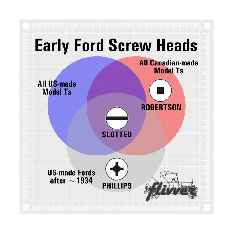

Unwitting, like a noob, I posted this picture on social media.
I was immediately 'schooled' about the incorrect Phillips head screws on my T dash. It's a US car. So I did some learning, and believe that this is now correct. Is it? TIA

With regards to the types of screws your chart is correct. However, screw heads are also different over time, those shown are flat head screws. As to the 26-27 ignition switch, you should have oval head screws, they should be nickel plated and slotted for a flat blade screwdriver.

The only place I've ever found Robertson screws on our Canadian T's in Australia are the 4 holding the steering wheel rim to the spider.

Maybe this is a better diagram? What do you think?

You got it Steven.

The artsy Venn diagram implies screws introduced after 1935 were used in assembling Model T's that went out of production in 1927? For that diagram to be correct you would need at least one additional axis to show time and probably a fourth to include all the shapes, domed, pan, along with the made-up names, etc,

I don't understand. I think that the Venn diagram correctly shows that US Model Ts use only slotted head screws, and post 1934 Ford's use both slotted and Phillips head screws. Am I misunderstanding something?
jab35 wrote:
Fri Jan 14, 2022 10:12 am
... you would need at least one additional axis to show time and probably a fourth to include all the shapes, domed, pan...
I'll think about how to indicate time and/or head shapes... But I am not sure where I can find more precise timeline info regarding screw types and shapes.

If I were a first-time observer of the diagram and chart below it, without the benefit of the discussion that preceded it all, I would have the following questions:
1. In the Venn diagram the intersection of the three screw head types is labeled 'slotted', the diagram title "Early Ford Screw Heads" but including the Model T era and US Made Fords (~1940) implies an evolution of screw heads over time from the beginning of the Model T to ~1940, so maybe Rob and Phil pre 1927 are the genetic parents of Slotted ~1940. From the discussion earlier in the thread, I think the diagram is meant to show "Screw Head types used by Ford in Assembling the Model T". Of course if Philips wasn't used, that Venn would have only two categories. A Venn showing "Screw Head Types used in Original Factory Assembly AND by Those who owned, repaired, modified, improved, restored (etc, etc,,,,) these Model T Ford cars up to and including the present date" would be much more complex, and much more interesting. I believe Martyn Vowell might need to be consulted to pull that one off.
2. The early heads profile is good, again the timeline of use of the various types in Ford Factory manufacturing would interest me. And are only sheet metal fasteners considered or are 'Screw and Bolt heads' included? And slotted, Robertson, Philips, torx, etc? Since this began as a Model T fastener thread, I'd respectfully suggest highlighting the Model T specific ones a different color, 'Pre-1930 could include some not used in the manufacture of the T, but certainly all of them and more have been used to keep the cars going since, and in the manufacture of replacements parts we all value.
FWIW, Respectfully, jb
