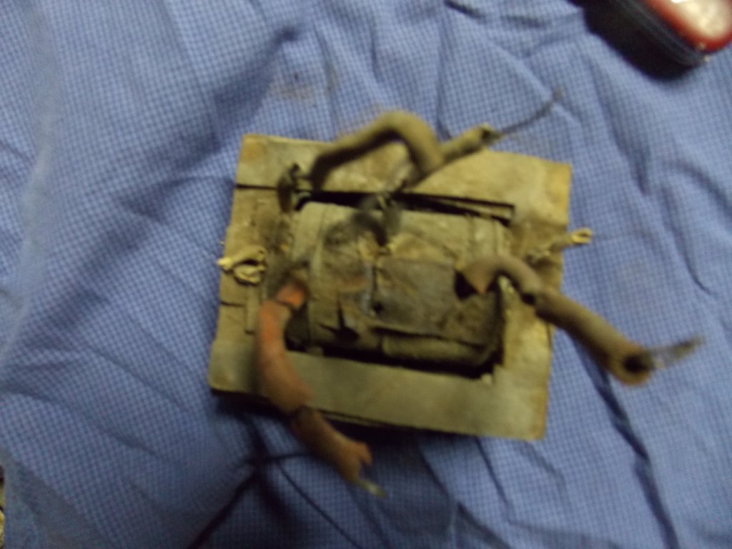

This is out of a pieces/parts tester I picked up at Hershey several years ago, it has six leads coming out of it. I believe the two reds are 110v and the other four are six or twelve volt. I tried at that time to test it but kept blowing the fuse on my test outlet. I've got a couple of older doorbell transformers I might try instead. Jim
Measures about 2 1/2"X 3" and maybe 2" thick.

Re: Jefferson coil tester
Post by BE_ZERO_BE » Sat Jan 15, 2022 3:49 am
Here is a schematic I made when I restored mine.
Jefferson Coli Tester Schematic.pdf
(15.48 KiB) Downloaded 153 times

Posts: 8400
Post by TXGOAT2 » Sat Jan 15, 2022 9:43 am
It looks like the operational test applies 6 volts AC at 60 cycles. I assume the lamps are for continuity testing. The 18 volt tap is unused. It could be used to "high-pot" a coil to simulate operation on MAG.
Post by TFan » Sat Jan 15, 2022 10:06 am
Thanks for the diagram Bob. Jim
Post by Jim-B » Sat Jan 15, 2022 11:16 am
I want to thank you guys for the information regarding the Jefferson. Coil tester. I can see I am missing
A transformer of some sort. I think I will use a small transformer, maybe 6 /12 volt unit. I realize the tester
Is basically a go- no go device but I just wanted to restore it as a working novelty.
